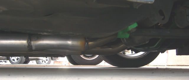

              They touch the subframe. You'll need 4 washers on/under the passenger motor mount. They definitely won't stay pretty either.

                    That's after a few weeks. The shine goes away almost immediately and starts turning yellow/purple/whatever.
                    They're not worth the effort it takes to squeeze into place...however if you don't have a/c, you might be able to put them in from the top.
                    I noticed a nice boost in the vanos-comes-on stage; 5th gear actually moves the car now, but I went from OBDI headers to these. Probably no change going from OBDII.

                          shots of the underside please if you have some.

                              That's as good as you're getting because I don't feel like taking a picture right now. Touches nothing else but the subframe...might just be my bad luck though. You shouldn't be using the O2 bungs anyways since you'll only have one sensor, so quality isn't really an issue.
                              They sit rather low.
