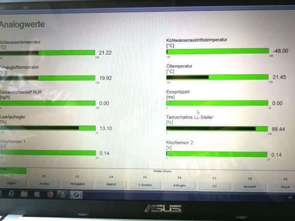

              So i got a friend to read the analog values via inpa, see picture.
              The throttlebody only opens a little when ignition is turned on, closes when engine is cranked.
              When throttle is pushed a approx. 25% the value of the ICV goes up by 2%. This depends on how much the throttle is pushed, the value can increase up to 92%

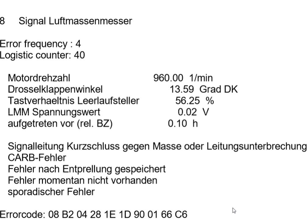

                            It throws a bunch of codes, the only one i have right in my head is code 8: Signal MAF Short circuit -> screenshot from inpa
                            • pazi88
                              • Sep 2015
                              • 584
                              Well that's then quite clear. It's still maf problem. The engine won't run normally untill you can get rid of the maf fault code. Or of course the ecu could also be broken. Test with 100% working maf from running car. If that doesn't work, ecu is broken. (Or wire is broken somewhere).
