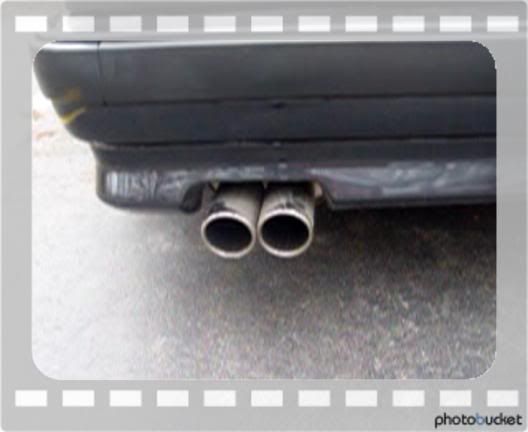

    Give Turner a call, they have a set of shorty headers that are modified to fit an e30s5X swap. They are a bit pricey, but were "worth" it (for me at least). If paying almost $1k for @10hp is "worth" it to you, then check them out. The sound is freaking sweet. Here's a quick clip of my totally custom exhaust system before the competition headwork, valves, porting, polishing, etc... was done. It's even meaner and louder now. Parked cars with their alarms on are my favorite things to drive past :D

      Cool, thanks for the 411, that thing sounds sick.

        You ain't heard nothing yet. I don't have a recent sound clip, but it's even nastier now.
