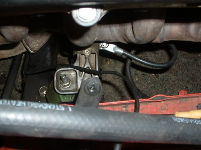

      Mine is placed here to free up the clutter on the other side of the engine bay. Canton Mecca aluminum catch tank, about $55 locally.
      • BeirBrennerE30
        • 2740
        how did you route your lower hose??? over the back of the engine?

        • 1990m3
          • 1180
          put a coolant hose in front of the aux fan to keep the engine bay clutter down, used two alumium L-shaped coolant pipes to go around the corners with no kinks. I pulled the motor to do some bodywork, I might do it differently the second time around. I had no issues with coolant temp or pressure, using a 16psi cap I think

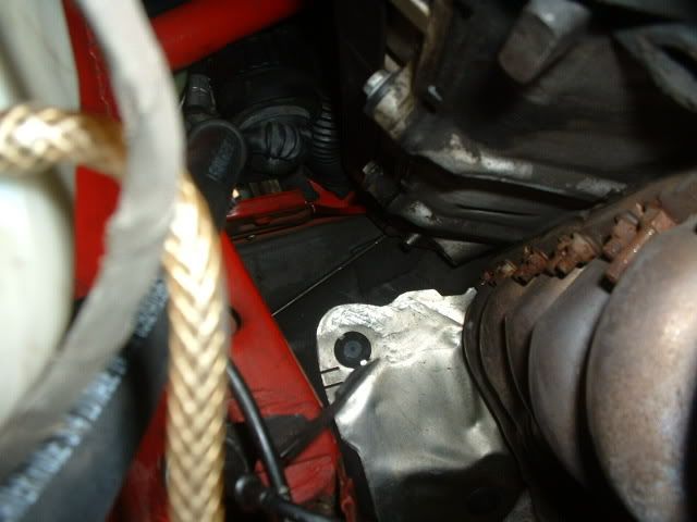

                  I did pretty much the same thing as 1990m3 did just i used the stock reservior, originally planned to route it behind the enigne but space was tight. it's working fine so far and the coolant hose is not as close to the manifold as one would think.
