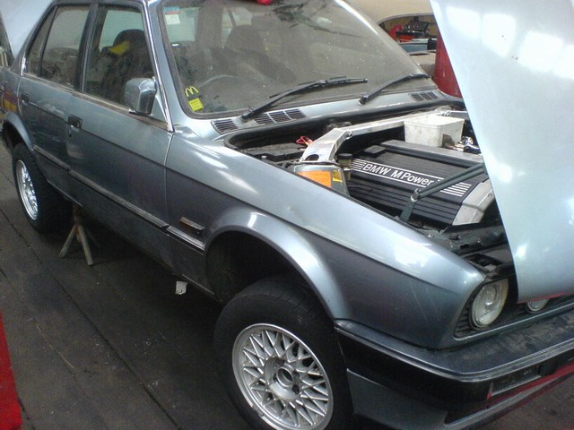

    My m50 swap exhaust setup
    Since I've seen a few people asking about the exhaust side of the m50 swap I thought I might put a link up to my thread on our new zealand based forum.
    Got some pics on there of the extractors getting made up etc
    Any questions just ask..

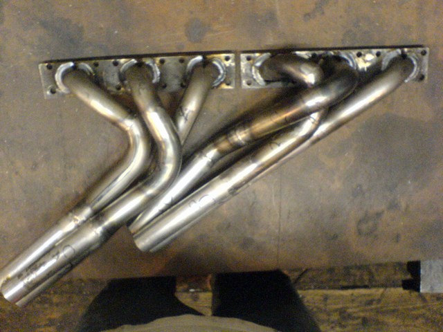

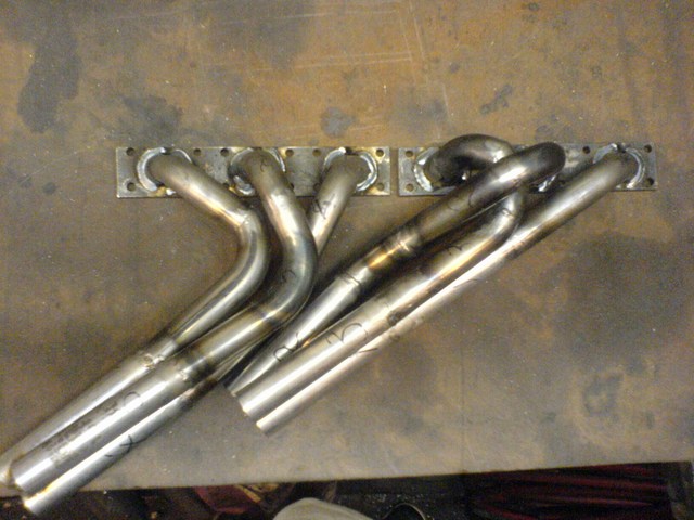

        Pics
        Pics

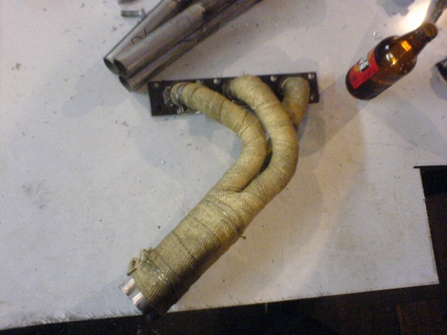

          Anyone used heatwrap before
          Whats this heat wrap stuff like???

            I wouldn't suggest using it. It's been known quite well to cause cracks from over heating. Plus it holds water and starts to decay the pipe.
            Looks pretty good, hope it flows well.

                  Originally posted by joshh
                  I wouldn't suggest using it. It's been know quite well to cause cracks from over heating. Plus it holds water and starts to decay the pipe.
                  agree with joshh
                  over here the high humidity eats up the pipes from within, worst still is you can't really tell if the pipes or wraps have bitten the rust/dust
                  there is also the possibility that oil splillage can cause smoke and fire to the wraps, was just informed about this from an amg driver as he spilt some engine oil on the wraps and had to idle out the car as the wraps was heavily emitting smoke

                      Yeah the main extractors are all equal length to within .002m cubed as we filled them with liquid and meassured the capacity so pretty happy with that.
                      As far as the wrap goes ..... I havn't tried it before .... others say it's awesome others say it's not I've used ceramic coating before and it's expensive so will give it a go for a while and see.

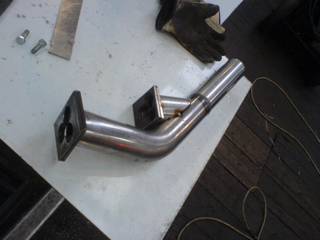

                      Spoke to my engineer mate and he rekons there might be a bit of resonation and vibration but he's welded everything up tough and the flowing gasses are kinda collecting into a bigger diameter ( no restriction at all ) so these will be minimal. Plus we don't have exhaust laws down here so I'm running a 2 1/2" mild steel rite through with 1 resonator and 3" truck muffler. Going to finish it this morning so will post pics up tonight

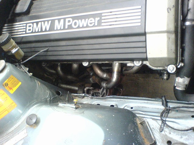

                          yep all finish and road legal. Running quite well except I'm not sure if my gearbox input shaft is actually in the spigot bearing. hence I think it's floating round. Haha got 180 kmh out of 3rd gear today with my new 2.93 Lsd
