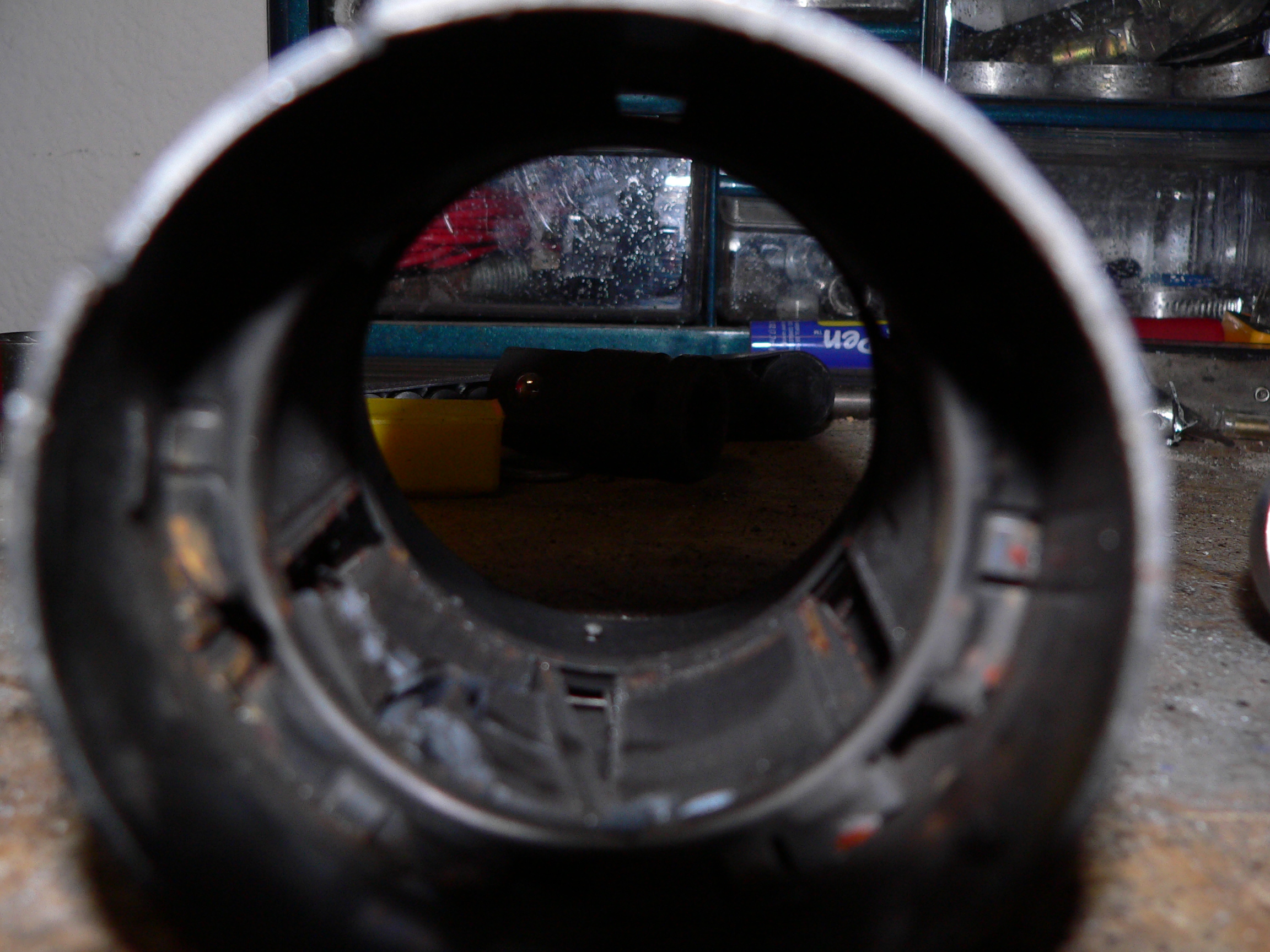

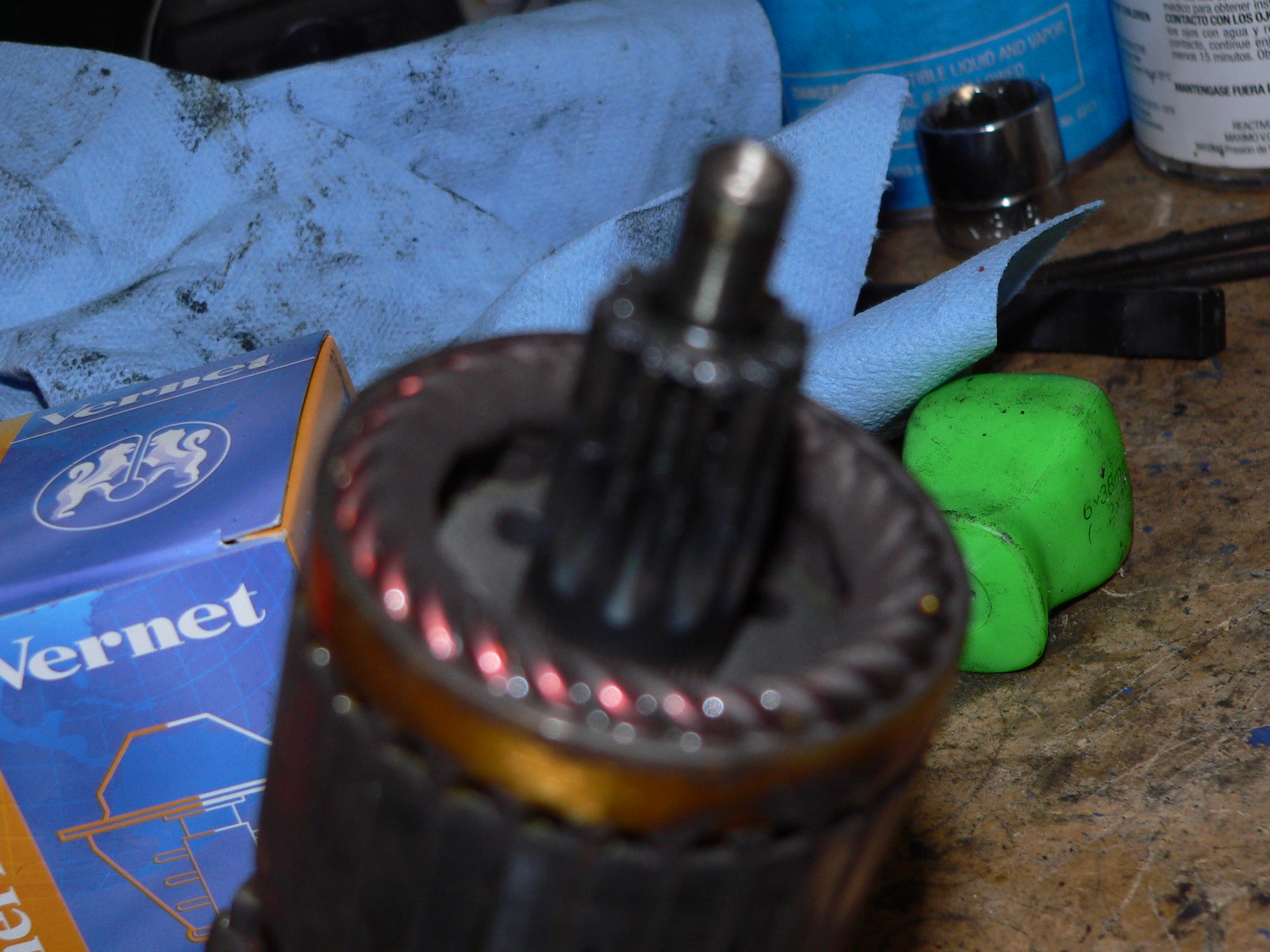

This is what I found.
So I figured I would swap the top of the starter assembly onto a good E30 lower assembly that I had laying around. But the engagement gear into the bottom end of the starter was different with nearly twice as many teeth.
So what I ended up doing is was swapping the inner motor assemply into the old housing. BY the way all E30 and E36 housings are identical.

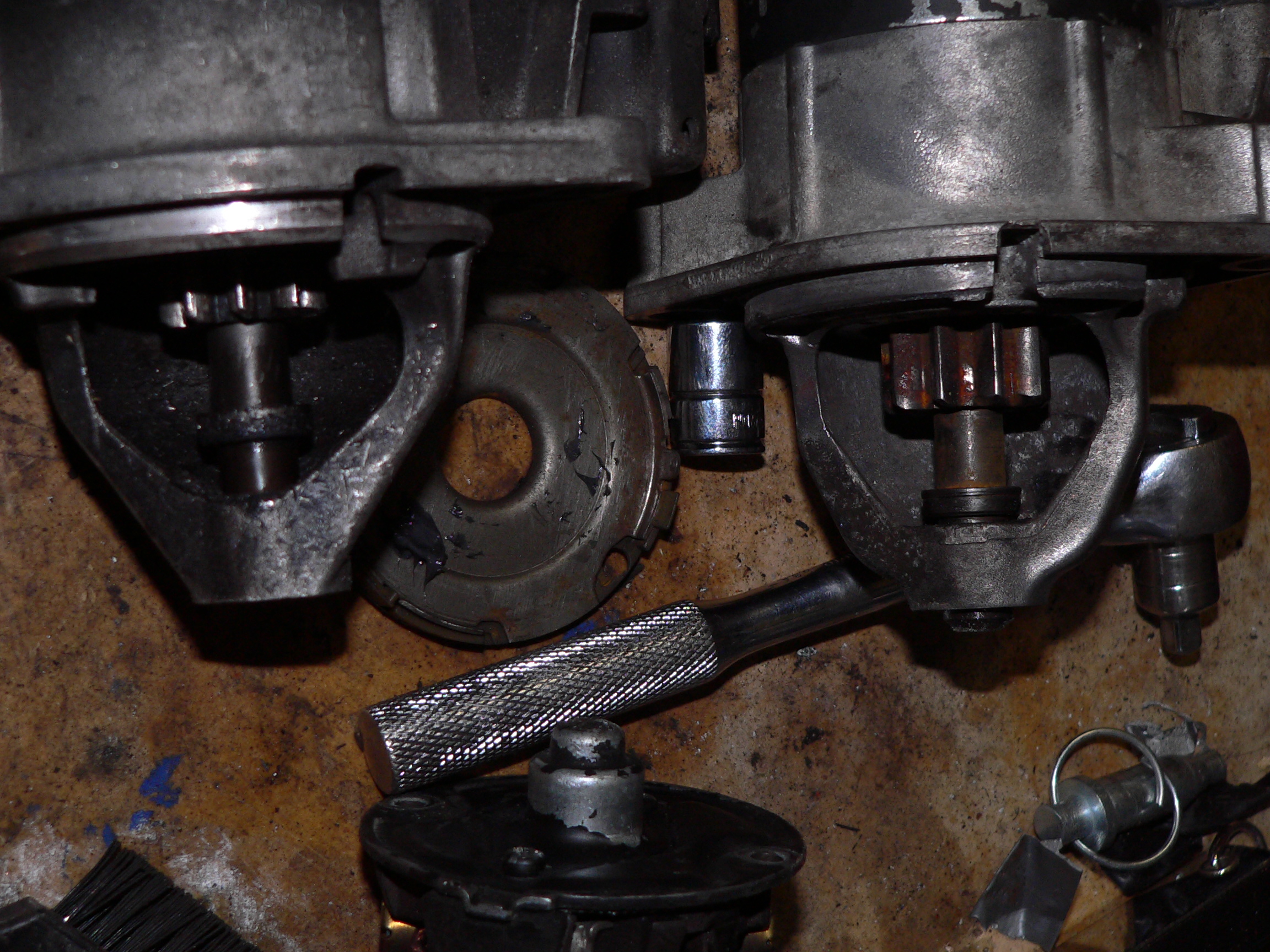

Here is the E36 on the Right and the E30 on the left
