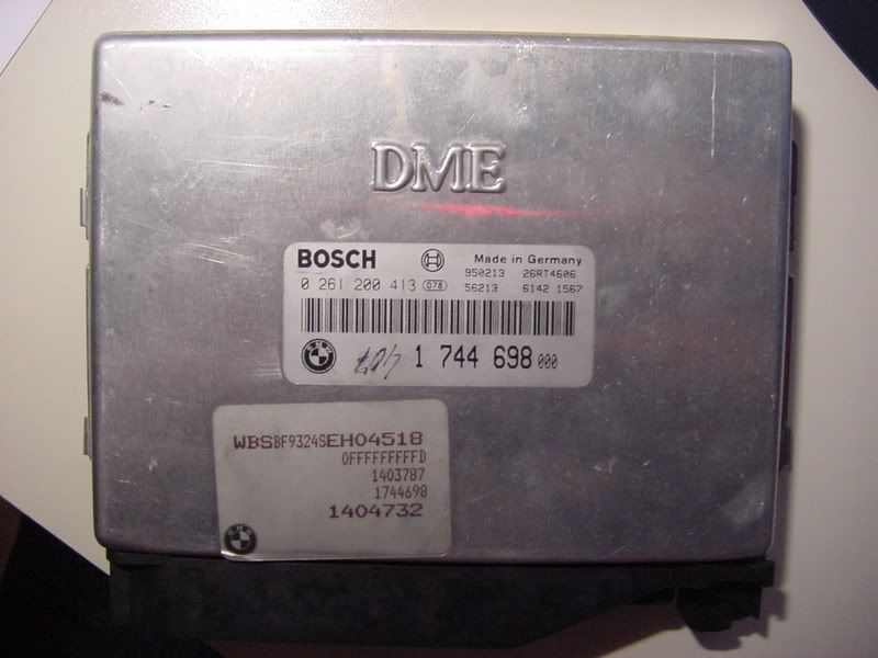

    So judging by the face sticker, where can you figure the year/month of build?
    The best I can figure so far is to use the VIN sticker to decode year, but there has to be a date code. Best I can figure is the grouping just under "Made in Germany" on the left. 950213 - so Feb 13, 1995 maybe?

      If you take the last 7 digits of the VIN on the DME (WBS...) and put it into RealOEM, the car that comes up is a 95 M3 with a build date of 2/95. This matches the code 950213, for a February 95 build date.
      I would think that this DME has EWS based on the build date.

        Good idea on using realoem. Yeah, I was thinking it was a EWS box - I forget why, but when I got it from Joe, he might have said something about that. To be honest I hadn't gotten that far, so it was still something to work out.
        So maybe we can all go by that little date code, since it seems to be that.
        Just so I can get it right in my head - Some silver label are EWS, some not. But all red label are free of EWS, correct? And using this little code, if it proves out as a build date code - can tell you if you need a EWS defeat chip or not.
        Anybody else care to add a shot of thier lid and see if that comes up as a correct date code on realoem. If so, this might be good info when you see a 413 to be able to determine EWS or not.

            This is an EWS2 enable DME. IT has a manufactured date of 2/95
