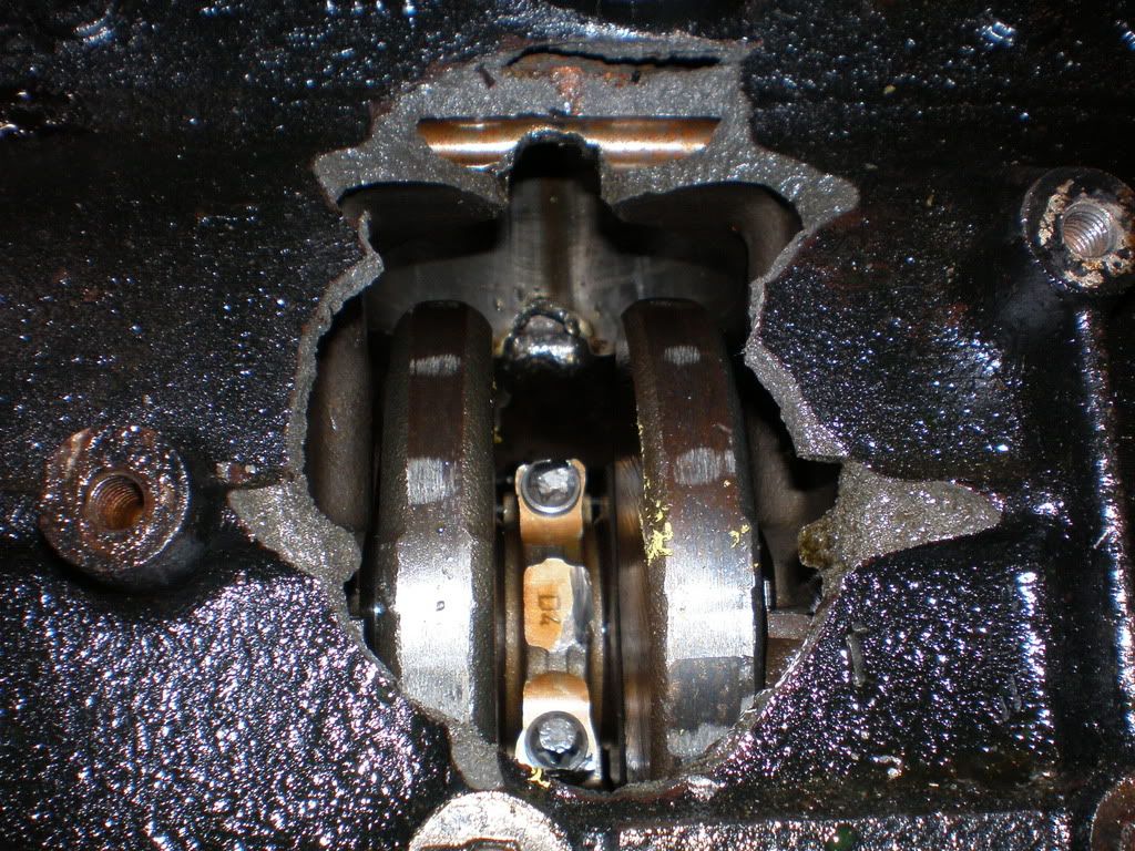

          Block survival is not breaking in the first place. A bent rod means the engine is rebuildable. a broken rod means the engine isn't, as it has a "ventilated" crank case and such.
          you get 3 guesses at what did this:
              I'm going to go ahead and point something out. When somebody says "survives in one piece, maybe bent a little, but one piece" that means that it did not break, whereas when they say "when it breaks" that means that it broke. I just have to be a little bit of a jerk, and I'm sorry.
              Oh and 3 guesses as to what did what?

                  There's a lot of "tone" here, especially given that i'm trying to be nice and helpful in my corrections. You know when you try to help a 3rd grader with their math homework and they try 3 x 7 and come up with something other than 21... and argue with you over the answer?
                  Yes, I'm sorry billy, I'll give you a calculator so you can finish your arithmetic.
                  your selection of words shows me that you haven't covered a lot of engineering books. Your description of how things work also shows that. I'm not being an ass, I'm stating a fact.
                  Ok so because I don't use the same terms as you I can't possibly know what I'm talking about. Of course, how could I be so stupid. I use different terms, yes that's a great argument.
                  A degree means that you read the books, took the test, and PASSED. There are plenty of people who read the books and don't understand it as well as they should... and thus they don't pass and don't get a degree. Sorry, thats not just how I feel, its how it works. Guess which group you have something in common with...
                  The group that never took the test I guess. That's really conclusive. Wonderful thinking dumbass. Now what about the standards of the test? Hmm I know alot of morons who graduated college with engineering degrees. Memorizing things for the span of a final is the ultimate way to demonstrate intelligence. Don't make me get into that. You didn't graduate from any terribly impressive school or you would have mentioned that by now. I know because you're arrogant and you would have worked that in. Without any reasonably groundbreaking standard, I'm still not impressed. I have passed many of my college classes (in computer science, in the engineering department of my unimpressive college) while not trying in the slightest. Sorry, not convinced there. Just because I had a different major, don't mistake me for a fool.
                  By that definition, when is the rod not at an angle? TDC and BDC? We were discussing your "angular compression". which is just compression ... where the rod happens to be at an angle to some other frame of reference? the rod is still just in compression. The force is still compressive. in the middle of the rod, what does the force look like? Is it at some funky angle, or is it just in the plane of the rod?
                  Actually I'm talking about angular compression in a failure mode, where resistance to bending is important. You never addressed that ever. I've seen the rod you're talking about fail. With eyes that are in my head and attatched to my brain. I.E. real world application not just some stupid test you took about how shit SHOULD work. This is how it does. The rod bent really well, yes sirreeee... 180 degrees then it snapped. Remember how you said that was bad? Well it was. Really bad. If it had more resistance to bending, which I believe would mean that it bends less (not doesn't bend at all which is what you seem to think I'm saying) it wouldn't break it would bend less and the piston grenading would have taken up the slack and it would have done just what i said, which is score the balls out of the block but live to die another day. Failure mode engineering, a term you keep ignoring.
                  the lateral translative force does not go through the rod. the rod has all in plane loading. the forces on the "other" axis go through the block.
                  The observation you made is possibly correct, but your conclusion is wrong. the bending always happens in the direction of rotation of the crank because the crank is emparting a force on the rod. the most common reason for bending like this is the piston can load the rod in such a way as to twist it. the piston can spin freely in the bore without issue, and translate that twist to the rod. the rod however cannot twist freely and without consequence, and binds on the big end grabbing the crank. Even if that isn't the main cause of the bend, it is part of it, and the reason for the direction of the bend.
                  You're assuming too much. You're assuming that the conrod bearing and crankshaft bearing are properly aligned and lubricated. First you ignore failure mode engineering and now you suck at talking about it. Ok, when something fails, what happens? It doesn't work right. Let's go under the assumption that... um... ok how about a big rock hits the oil pan and the oil goes out and now your bearing is starved for oil and seizes. No lubrication in the bearing at all. Now your translative force is applied to the rod at the same time as the engine pings and BOOM. The rod compresses hard under high boost knock and fails, now the translative force is applied and it bends. Now what happens?
                  Ok I suck at talking in your language apparently so I have officially called in a translator....
                  " The real instance of lateral force comes from the rotational component of motion inherant to the rod. It points always outward away from the crankshaft's center, but that's sometimes parallel, and sometimes, perpendicular, to the conrod's length."
                  And when that fails?
                  AHA!! A valid argument pertinent to our discussion! Eureka!
                  When an H beam rod fails, if and when that happens, I'm certain that it would buckle and bend inward, folding the structure on itself like when you watch an I beam bend on a bridge when it collapses. It would probably do so in a fairly linear manner and absorb a FUCKTON of energy in the process, thus averting disaster and saving our fair city. Err, engine.
                  I beam rods are more forgiving. they allow more flex in plane and thus are less likely to be damaged by detonation. H beam rods are stiffer in that plane, which isn't always a good thing. The H also usually has longer THINNER ribs that can flex and allow the rod to bend in a bad direction.
                  Which is why nobody in their right mind would buy a titanium H beam rod ever and put it into an EVO making almost 1000whp. Nope. You're right. I'm an idiot.
                  Crank twist is large. Hollow camshafts are unhappy in BENDING. They don't do that in a running engine. Much of the hardness required there is for wear properties. They don't have the harmonic issues of the crank either from both stiffness and reduced rotational speed.
                  Yes they are unhappy in bending but they like twisting. I'm actually not being sarcastic, I agree. I'm just using that to show that if I put words in your mouth and argue against them, I can be a jackass on the internet too. Now you know how I feel.
                  I notice that you are upset being wrong. Every time you reply you reveal more of what you think you know but don't. Perhaps you are in a family of engineers, but unfortunately knowledge like that isn't passed through the placenta. You've probably read or heard enough to know some of the lingo, but not enough to understand the principles.
                  Uh huh. You're so right. Yes. You are so superior to me. I'm sorry I ever doubted you. You are the master of the universe. All hail king you, master of the terminology.
                  My dad is a doctor, my mom is a nurse, I've read enough and been around enough to have a decent understanding of the basics, but I don't argue medicine with surgeons.
                  Actually, to be perfectly honest, this is more along the lines of a surgeon pointing out god's mistakes. Except you only think you're god, I know I'm a surgeon. In relative terms.

                    • triggrhaapi
                      • Feb 2007
                      • 350
                      #55
                      Well this proves that trying to be curteous during an argument on the internet is pointless.
                      Here's another translation from an engineer buddy of mine:
                      "wtf? Hell, just the fact that H-beams exist should be proof that there are lateral forces: those lateral forces are more evenly distributed in an H-beam rod, which is why they can be stronger in compressive stress situations."

                            #58
                            Replying to your post line by line is too time consuming and you're too stupid to see what I'm saying anyway. You twist my words and misunderstand my points and arguments. It is PAINFULLY obvious you don't understand the argument. that was my basic math example above...
                            so down to bullet points.
                            - you continue to say "angular compression". In physics i know of no such thing as it applies to a connecting rod. I can apply it to light, and I can apply it to data in a CS sense (I have 2 CS degrees, btw.)
                            Now lets look at a connecting rod. We have a BEAM with bearings on both ends. if we apply an in-plane load to it, nothing moves. if we put a lateral load on it, there is no load change on the beam, and it just moves sidways pivoting on the bearings. I'd hate to be forced to draw you a picture. (I got good at those while getting my physics degree.)
                            - failure modes. I covered this already, but bending is WAY better than breaking. A bent rod is still attached to the piston and crank, and might not even touch the cylinder walls. A broken rod does bad things.
                            the picture I wanted to link before is this:
                            - Notice that I give an engineering reason behind something, like the difference between H beam and I beam rods, and you come back with some OBSERVATION like someone has used them in an engine that did X. Thats not a good argument. I can move the level of discussion between rod designs up to the math behind it, can you? would your "my buddies EVO used those rods and didn't break" hold up well in those cases? If its an engineering discussion, keep it that way.
                            - I'm amused that you think you're a surgeon and that engineers are gods. but if thats the case, why are you arguing with me? You very ovbiously don't understand this stuff. reply with a diagram of the forces on a connecting rod and maybe I'll explain it to you some more.

                              #59
                              Thats a translation? what language does he speak?
                              Lets look at H beam versus I beam here for a sec...
                              H beam: easy to machine from billet. made popular ~4 decades ago by carillo. Still popular mostly because its an obvious change from stock. Usually long thin ribs that are much longer in the plane of the rod. The ribs being deeper increase the stiffness in plane, but they are also generally so thin that they want to flex at the outside edges allowing the beam to bend.
                              I-beam: easier to forge. Typical OE construction for rods. It allows for more in-plane flex and is generally more forgiving because of that.
                              Both are approximately equal in tensile strength.
                              H beam rods are more popular in applications where no detonation will occur. I beam is more popular in applications where detonation may occur as they are more forgiving. At least thats how it works in engeering race cars world. The street car side of things loosely follows this as its "engineering" is largely based on occasional observation of what race cars do... and not always looking at a comparable race car setup.
                              We can go as deep into this topic as you'd like.

                                #60
                                Hahahahahaha I get to reply to this with a quote from my last post!
                                Yay! I get to save time and do it again!
                                Fair enough, let's look at the structure then. An H is an I turned sideways, and in this case turned in such a way that, as you said before, the bulk of the beam is two flat plates joined in the middle. The whole reason that those rods exist in the first place at all is to resist bending. The structure isn't terribly resilient bending it the direction perpendicular to the to the direction of rotation, so clearly this design points out that stresses in that direction are non existant, which makes alot of sense. However, the H beam design is very very strong in the plane of the direction of rotation, more so than an I beam design. The fact that people make these should really prove something to you. There is a lateral translative force applied here,and it only rears it's ugly head when the system starts to fail. You're still ignoring that if the crankshaft suddenly doesn't want to rotate properly, the rod stops undergoing compression only along the length of the beam. You're still assuming that when something fails, the system still works and that makes about as much sense as a fat girl buying a size 1 bikini, while being admittedly much less repulsive.
                                [/QUOTE]
                                Notice that I said relative terms? God I have to explain everything to you. Ok, what does god do? He makes stuff. What do engineers do? They make stuff.. Still with me? Ok. What do surgeons do? They fix people when they break (that is probably using the least elegant terms possible to describe the job, but whatever). What do mechanics do? They fix cars when they break.
                                So therefore surgeons pointing out god's mistakes are akin to in this case a mechanic pointing out an engineer's mistakes, using something I learned in college, the literary device known as metaphor.And yes, I was saying that you only seem to think that you're an engineer. Prove it and design a better rod with a superior failure mode.
