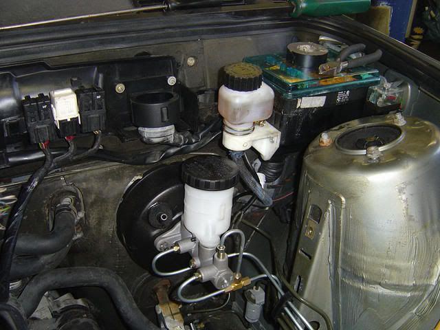

Anyone know what booster/MC this is
    hey guys......I've been lurking for quite some time. I had some technical difficulties with posting up, but thats all take care of now.
    I'm in the middle of rebuilding a non-vanos M50, and sticking it into a '88 325is. I also have a '86 325es as a daily beater.
    Anyway.....I have everything I need to finish my swap, but I was wondering if anyone knew what master cylinder and brake booster this is?
    It's a nice clean setup, and the booster looks small as hell (obviously if it fits fine with a euro motor jammed in there). I might change my mind and go this way if I can figure out what it is.

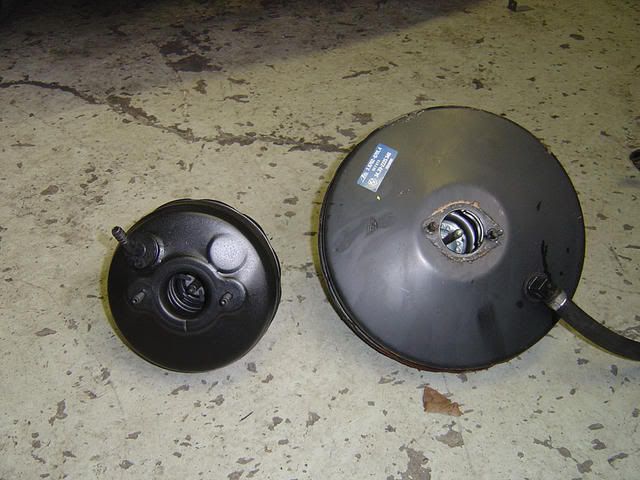

    the only boosters i've seen that small are 2002tii boosters.

      Asvedo's(sp?) shop uses tham on there euro twin cam swaps

        Bingo, that must be it. There were quite a few guys there that day that had the swap done at Azevedo's shop. I wrote down the shops name, but none of the guys knew what parts were on their cars. Most of them just wrote a check and walked away.
        Anyone here ever try it out? If so, does the ABS work properly and does the car stop OK? If no one has tried them out.......I volunteer myself as the guinea pig when I finally get that far (most likely by the end of summer)

          yes, its an early metro / swift booster. ive got one installed. car should be completed in a week or two. cheers, jason
            Yeah, I came across your other thread after I posted. I'm definitly interested in how it works/feels when you get the rest of your car back together.
