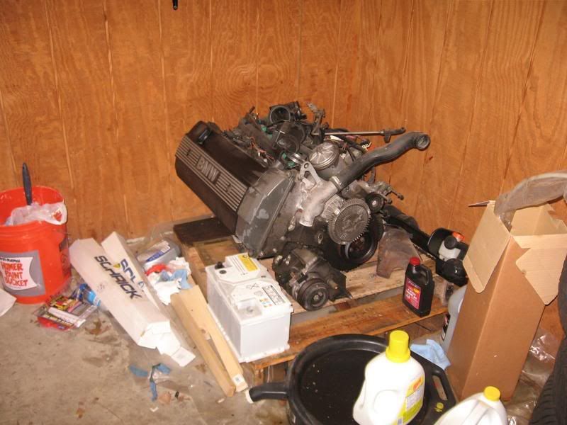

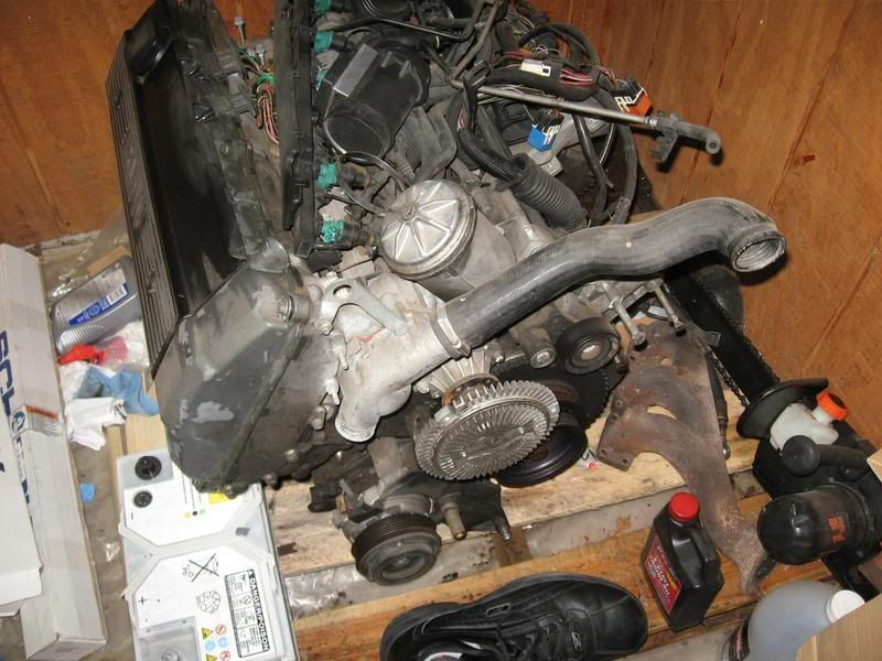

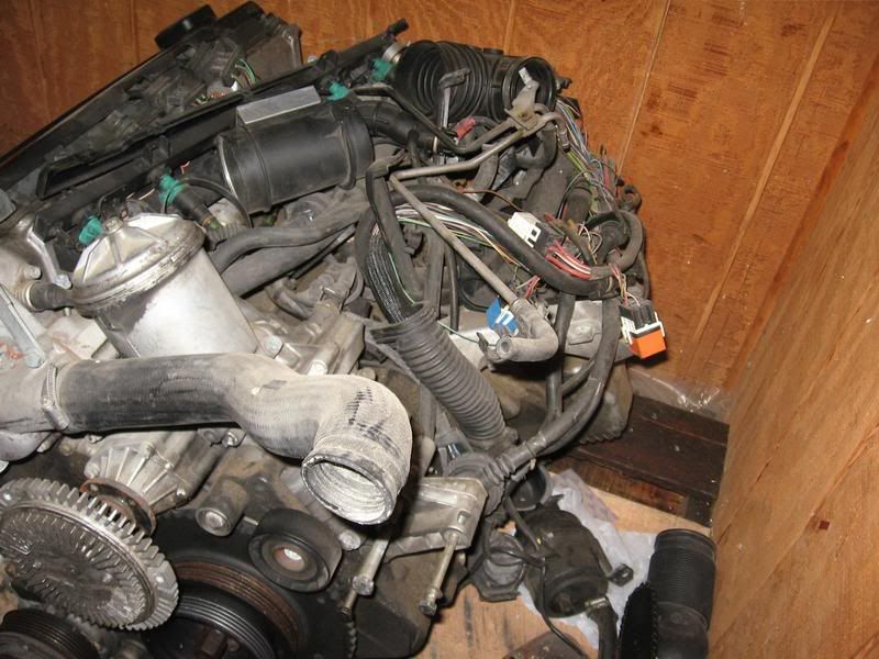

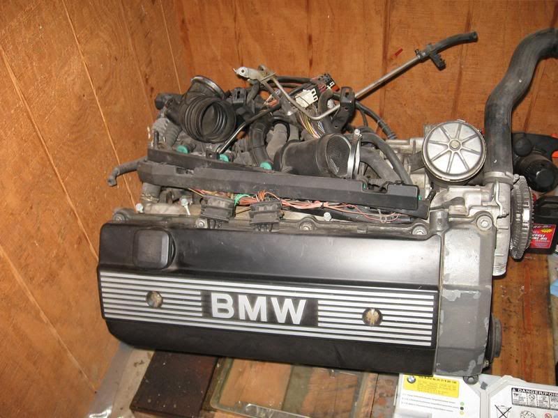

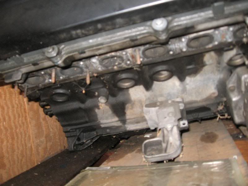

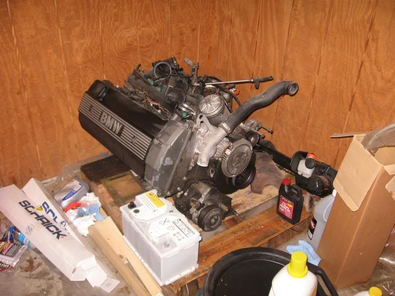

    Soo today I went over and looked @ this m50 motor, for my m50 swap, it's missing an intake mani, but i think he said he can get me an s50 mani because his brother swapped the m50 for his s50. It has no tranny, and it's missing some small misc peices. He also told me b4 they took it out the engine was running fine, but they just heard a noise/knocking coming out of the engine, he beleived it was a rod bearing.. but for 100 bucks, I don't think I can loose..
    I heard you can rebuild the m50 motor with s50 crank, and cams, to get 3.0 displacement.. I tried searching but I really couldn't find much about it on here, maybe I suck at searching I duno.. if anybody can link me to some threads or give me some info that would be great!
    I plan on tearing this motor apart and rebuilding whatever needs to be rebuilt.. it has been sitting for a year so i think it needs to be cleaned! But i was surprised on how clean it was.. It's a 92 m50 with 100k + miles on it.
    Also, the max I want to spend on the rebuild of the m50 with s50 internals is 1.5-2k.

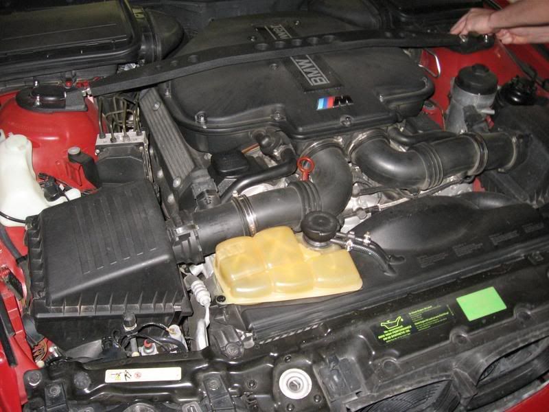

    here is a pic of the owner of the m50's sick m5
    and here is the engine engine that i really want :o lol

    Just so you know M50 and S50 (OBD I) intake manifolds are identical. Was one cracked or did his bro have an S52 (OBD II mani)?
    Yeah I'd take it for $100 too.
