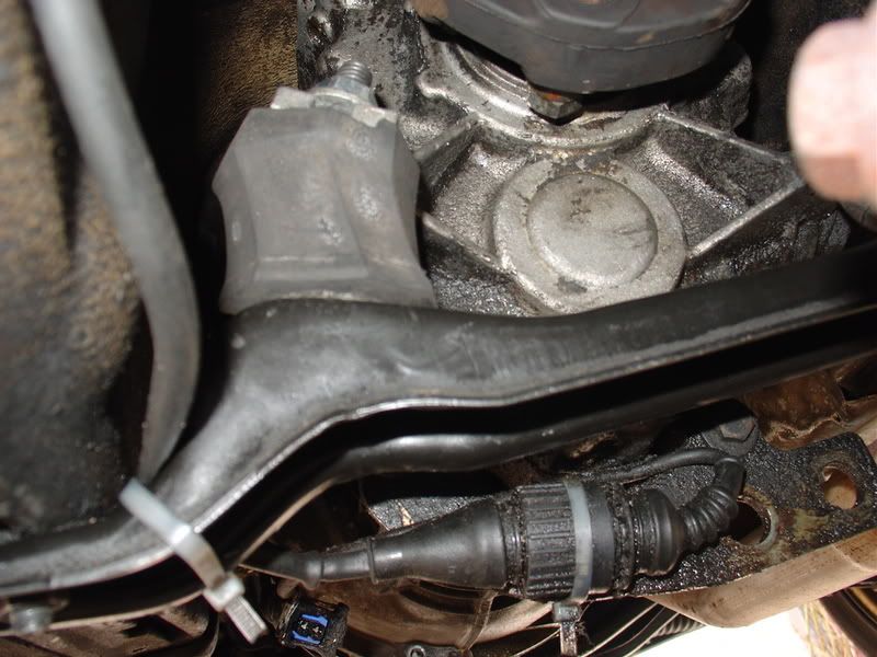

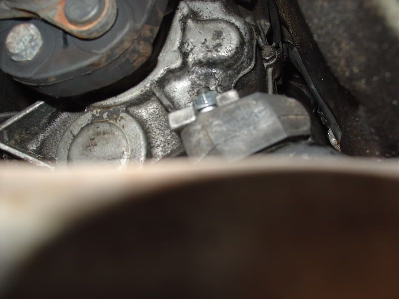

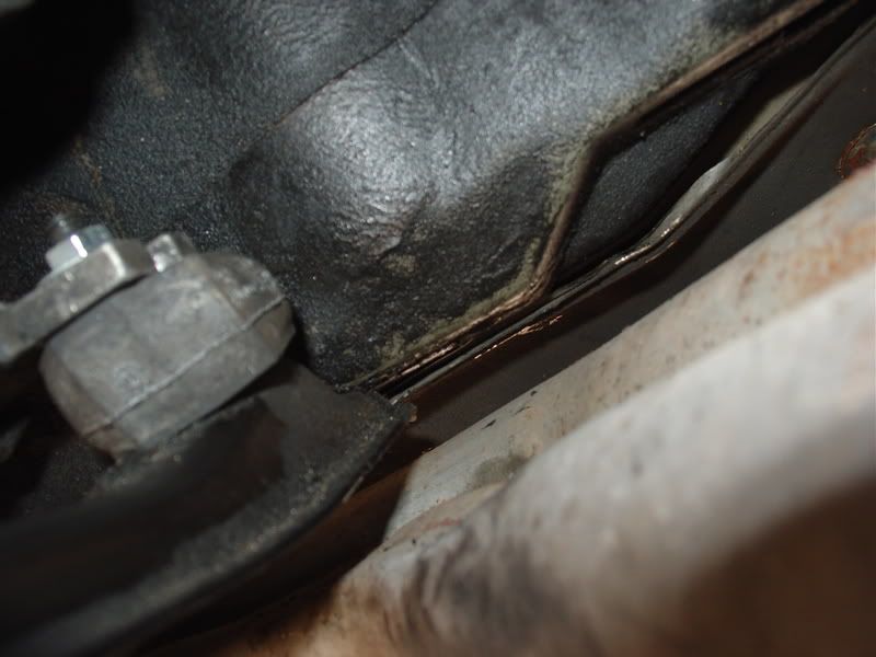

    i bought the mounts trent recommended and they seems to be perfect fit. i haven't test driven the car since it's late and i'm too lazy to move 2 cars. here are some pics. if these mounts fail i'm buying a tranny brace. i don't have the money to swap my ZF yet so this should do for now. $12 each for the mounts
    driver's side
    pass side
    1991 330is

    Post up those part numbers for the other people running that trans. Im suprised that you have the 260 as you have the s50 but to each his own. Check out car-part.com you can get the zf box for as little as $350.

      i do have all the parts to swap to a zf tranny except for the driveshaft. i'll probably do that when i mod the engine.
      here are the part numbers.
      driver's side - 23 71 1 175 732
      pass side - 23 71 1 128 372

            you are going to run that all stretched out??? looks like future problems

              the pass side part number is not working =(
                the driver's side is not stretched at all. the mount is really tall.
                1991 330is
                • trent
                  It looks streched to me, but I am using a small spacer on mine, as i am using a different driverside engine mount than most...
                  Yours does look "twisted" a tad also.
                    TTT
                    i'll double check. it probably moved a bit when i tightened the lower nut. the grooves doesn't really line up to the tranny ears. i just ordered the mount for the part number you provided. not sure it's not stretched cause i had to hammer the mount a little to get it in the tranny ears. i'll try and put spacers, maybe a washer on the top and one on the bottom.
                    which mount are you using on the driver's side?

                      out of curiosity, what's the sensor you have attached to the bottom of the transmission?
                        might be a bad location but that's my O2 sensor connector
