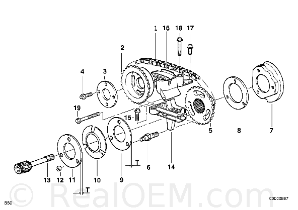

                          Originally posted by matt
                          So why will a vanos from this guy cure the noise, but a new one from BMW won't?
                          its not always the vanos that makes the noise. its the mesh gears. the dealer does not replace the gears or spring plates. always replace the mesh gear. cheers, jason
                          • Bmjpv
                            • Mar 2007
                            • 561
                            Jason, what are you calling the mesh gears? The spring plate I get/got but please make the mesh gears clearer. Thanks joe
                            • Jason89i
                              • Sep 2004
                              • 875
                              http://www.realoem.com/bmw/diagrams/d/a/9.png
                              no. 5
