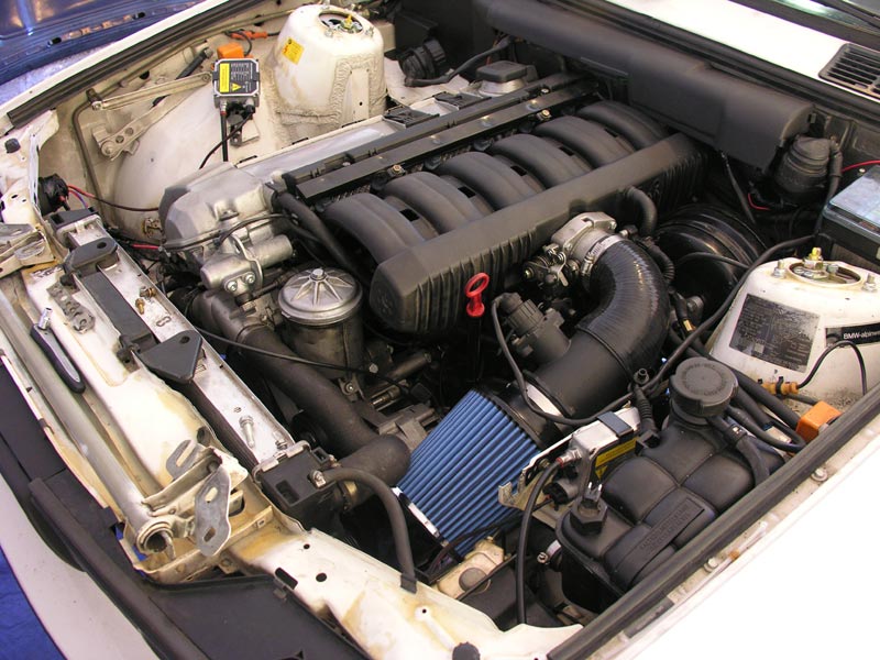

              I cut the chasis connector off an e36 with plenty of wire length. I then bought the M20 engine side connector from the dealer with the right amount of male pins I needed. I then crimped/soldered on the pins on the ned of the e36 wires that were going to be used and then stuck them into the right spots on the M21 connector.
              Here's a pic of it. You can only see the adapter since the other connectors are under the cover.

                  whats that black box on the pass. side by the strut tower?
                  nvr mind, you got hids dont you. nice
                    Yah. I wish there was a better place for it on the pass. side, but that's the most stable area I could find to mount it right now.
