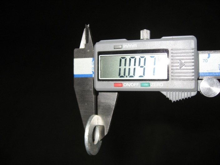

            I replaced both cylindrical mounts with the green metal ones.
            To get the exhaust to clear, I only had to use the washer seen below.
            I originally shaved the intake plenum fins and there is still plenty of clearance.
            I will admit that the cylindrical mount failed due to my negligence but I feel safer using the green ones as I can't see how they would ever fail.
