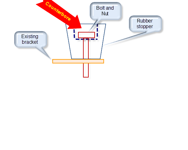

                      Solution:
                      M8 bolt, washer, nut, 1" wide, 3/4" long rubber stopper from Home Depot.
                      Drilled a 3/8" hole, 5/8" counterbore.
                      -Brandon

                              Originally posted by Beej '86 325es
                              Solution:
                              I probably don't have a photo anymore, but here's a quick diagram. You're basically just bolting something rubber to the top of the two brackets for the radiator to rest on...see attached diagram.
