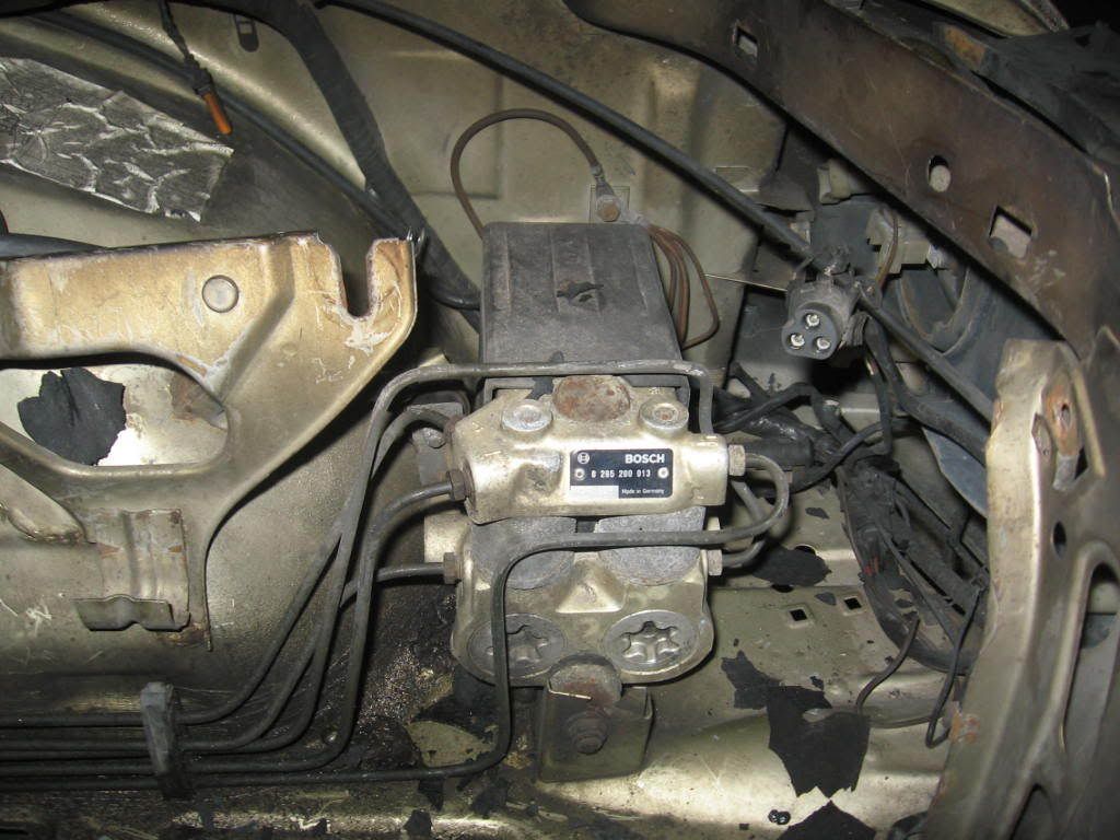

    Second
    This is in my car right now what the hell is this thingy. Is this an ABS pump i wanst sure because I know my car doesnt have and ABS light and i know i dont have ABS because i can never stop in the winter, all four lock up so if it is that means it doesnt work, and i would like to just rip it out i dont really like ABS not a big fan but maybe its just a fuse i need to replace and it would work I dont really know.
