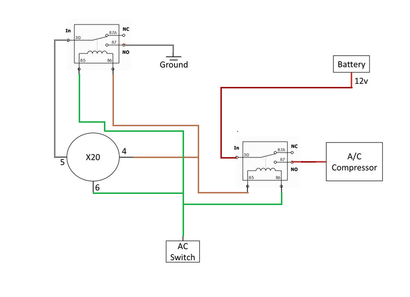

I know that we are hacking the e36 system to work with the e30, but what other "parts" could we be using other than the pressure switch?
Following is what i have come up with
can Anyone confirm this, or would this put too much strain on ecu by running two relays?
need to figure out a way to use the Pressure sensor with X20 Pin no 5 so the Pressure cut-off would work as expected
Well this is the solution I came up with for my setup and have run it for a couple of weeks now. Depending on the mood of the car I may get a tiny RPM stumble when the compressor engages, but it is 90% better than before as you can tell by the videos below.
I am not sure why my compressor cycles on and off in short 7 second intervals, so I will have to get the system pressure checked when I get bored.
So here is the relay diagram to ground the "activate AC" wire, which is black/gray and pin 16 for my DME, when the AC on/off switch is activated
Took me a white to find the black/gray wire in the bundle. Used a Positap to help with the connection as all it does is pierce the wire jacket to make a connection.
Test wired up the relay to the ECU. Red clip is taking 12v from AC on/off switch which is also feeding the signal to the AC on/off wire, which is violet/gray and pin 19 for my DME. Green clip is connected to ground.
Testing in the garage was perfect, no RPM stumble when the compressor cycles on and off. As I stated earlier, how the car acts when the RPMs change while driving was a bit different.
