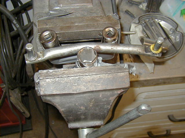

Shifter rubs on driveshaft

      Understeer recommends bending the selector rod in a vise, using three sockets.

        The selector rod is not rubbing. They tell you to bend that if yours rubbing on the guibo/hardy disc. My selector rod is bent just a little bit as well. I'm off to Vegas this weekend and just got to start my swap for the first time today. Started first try! Next week I'll have her on the street.

          um, sorry dude. I misread that! I thought you had rubbing on the guibo, not the DS! :(
