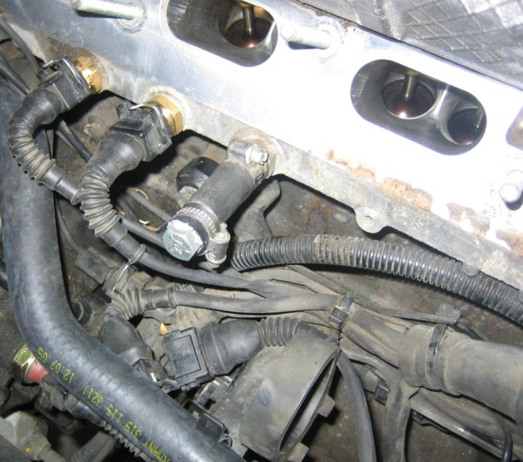

                        This is what I did.

                          Originally posted by cahomey
                          This is what I did.
                          thats alright but you can do it safer and cleaner w/ an oil pan bolt. The bold deff won't leak and it looks better. Thats what I did.

                              Well seeing as how this part of the motor is totally covered I'm not worried about looks.
                              Don't worry, my American bolt I found in a bucket will last forever. Gasket maker is a bonus but probably overkill.
