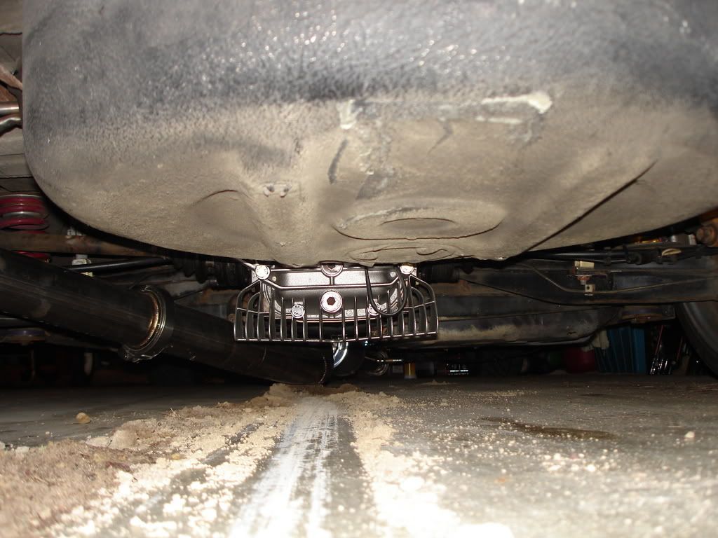

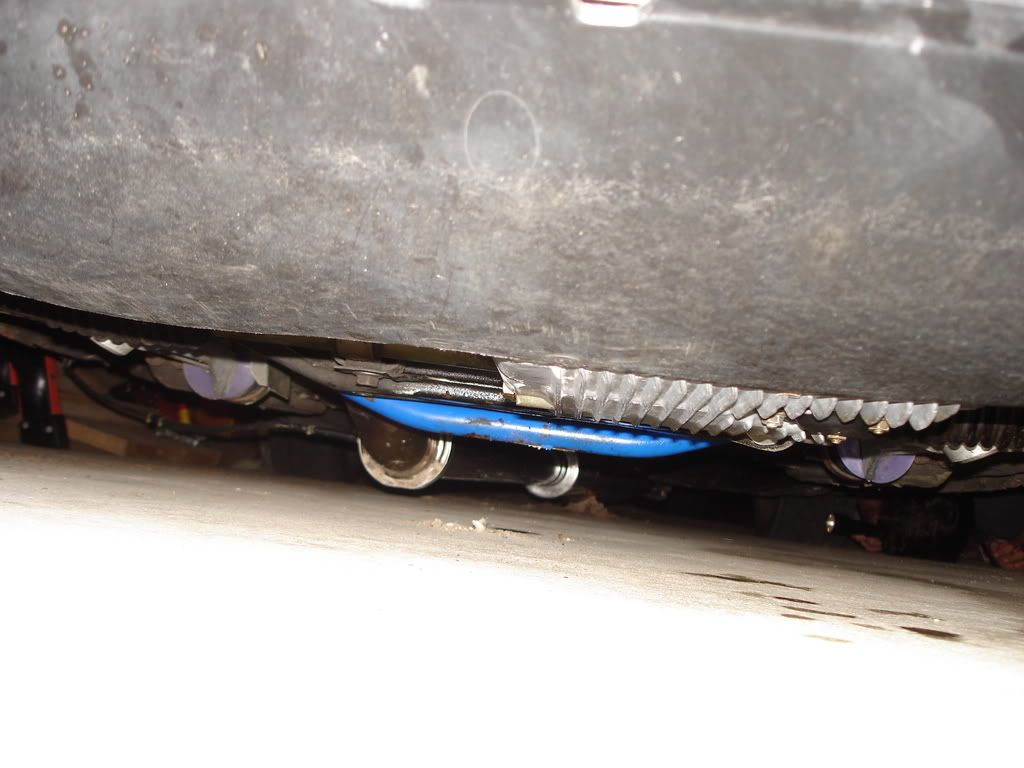

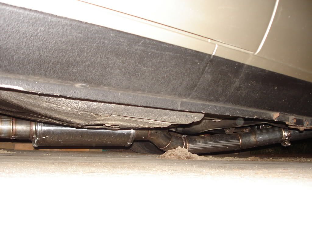

                      ok... here are 3 of the better pics. I can go take more of as it stands now but this was version A. Notice the ground clearence, or lack there of. Also notice the dirt and scores in the cement of my garage that the exhaust did.
                      From the front looking under airdam... look how low the front vband is and its poor placement
                      From the side of the door... i dunno what he was doing with the routing here. Notice all the random welds and the angle of the muffler and the distance the tubing is away from the car.
                      Last pic im gonna show you guys is from the back. Notice again the lack of clearence and also how the guy missed the point for the turn under the subframe. it is SOO much lower than the mcoupe diff cover

                        Not too much rust under there for a 20yo new england car ;)

                        • FredK
                          • 14751
                          That is pretty low!
                          I don't remember where there's room to tuck crap in because I haven't been under an E30 in around 4 weeks, but that is ridiculous! your car IS pretty low, though.

                                Wow.
                                I definitely agree, that's awful.
