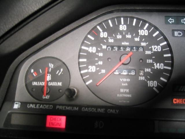

                What?
                My check engine light works great.

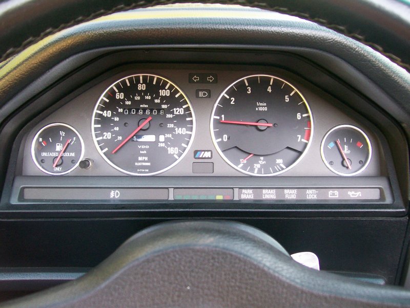

                  My cluster has no check engine light in it all all . i pulled the cluster and shined a light thru all the blanks not even the words CHECK ENGINE . 1990M3 may be different

                    It doesn't say check engine. Only domestics say check engine. It's to the left of the cluster, near the fog light lamp.
                    It's just a symbol.

                      three green letters then fog lights thats it . I pulled my harness boot at the connector under hood on the e30 side there is no wire on the harness . #12 I recall

                          1988 m3 cluster there is no wire behind the cluster either . from what I gather back in my old dealership days the CEL was on it's own seperate plug or was that abs ? anyways never had it and the cluster is an m cluster

                            • Rev Engineer
                              • Jan 2006
                              • 162
                              This is from my 88 m3. I think I had to add the bulb and run the wire over to the DME. It's an add-on like the ABS light.
