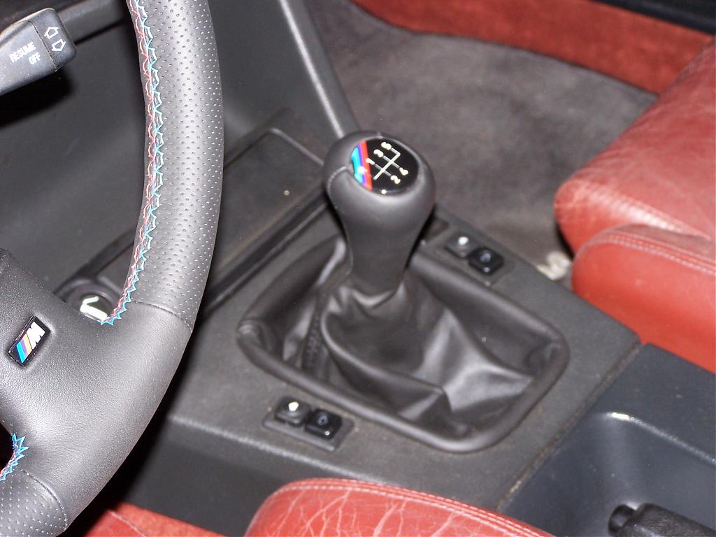

With regard to the shifter carrier, I found that the E36 shifter was not going to work in my conversion - it was too long. I used my original E30 M3 carrier that is slightly short but I prefer the shifter to be further forward than too far back.
For the rod, I used a good suggestion found on this site that makes "tuning" it very easy. I cut the E36 rod then tapped it - the I.D. is just right for a 12mm thread. I used a 12mm threaded rod (cut the head off a bolt) to assemble the rod. Then I carfully shortened the rod until the length and rotation was to my liking - a bit forward and to the left to minimize the reach from the steering wheel. Once set I had it welded. Image is shifter in neutral.
do you have any pics of your linkage setup? sounds interesting. its just the carrier im having a problem with, actualy i wont know where my lever sits till i have it in.Comment
he has a m3 i dont know it that would make a differnce or not.Comment
Unfortunately, I didn't take pictures of my linkage but it's nothing special, just the M3 carrier (same PN as a 325) and a shortened E36 rod.
There was an earlier thread titled 'Shift Carrier Question' that discussed some of the variations with photos. I can't believe there's any difference with the M3 tunnel and shifter opening but it was not going to be easy to make the E36 set-up work without it being pretty far back and towards the passenger. The E30 carrier was centered and a bit forward - more to my liking.Comment
