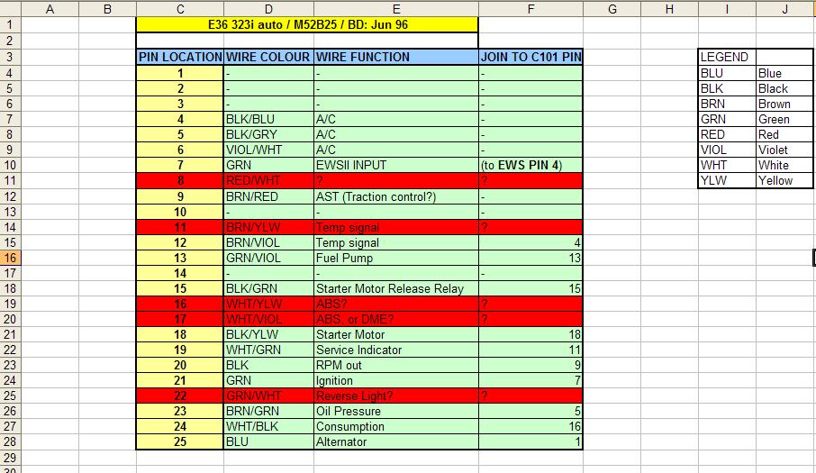

    OK, so its wiring time for me! I'd appreciate it if some of you could help, there's a few pins which are different on mine. I will be running functioning EWS with two keys.
    Remember these are Aussie cars, and there are subtle differences I have found.

    The pins I need help with are marked in RED. If anyone would like to edit, I'd be very grateful.
    Thanks to all,
