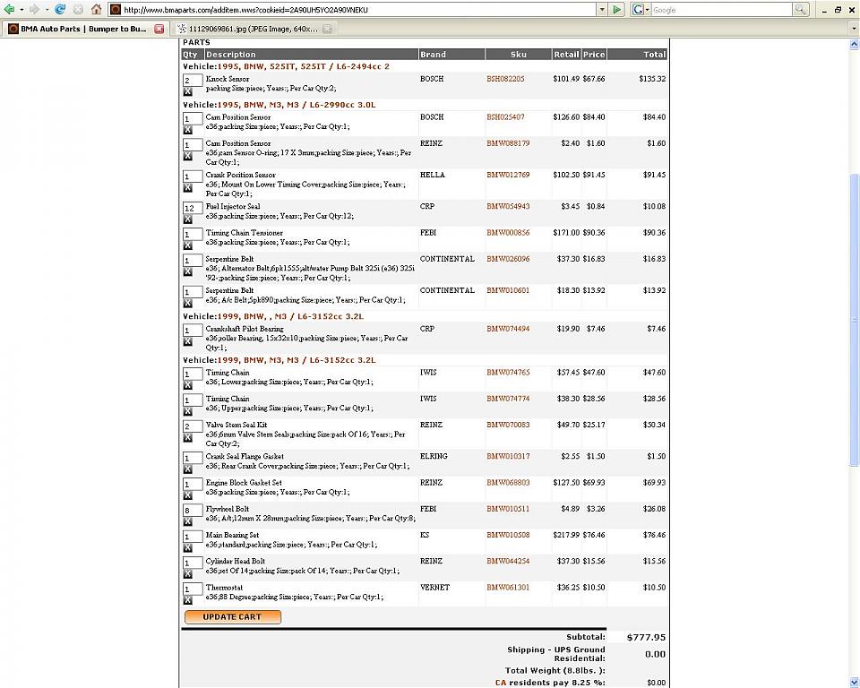

    S52 engine rebuild
    I am getting ready to place an order for my s52 engine rebuild. I know that I am missing piston rings and rod bearings but besides that does anyone see anything that I am missing ? Thanks Brian
  • FredK
    • 14764
    How complete of a rebuild is this?
    Headgasket set?
    The crank seal gasket comes in the block set.
    • bostonbmw
      • Nov 2004
      • 429
      woops forgot the cylinder head gasket set. I want it to be a pretty through rebuild.
      • e30serg
        • Dec 2006
        • 562
        Hey man-are you doing a full rebuild-including machining the block, doing a head job, etc? or are you just replacing all the rings, seals, etc.
        • kroberts
          • Nov 2006
          • 680
          Oil Pump
          All the bearings
          • PiercedE30
            • Apr 2005
            • 4220
            Main bolts, rod bolts.

            • madjurgen
              • May 2005
              • 1203
              If you truly want to be thorough, drop your head off at a machine shop, get it pressure tested, check guides for play, get seats recut.

              • PiercedE30
                • Apr 2005
                • 4220
                If you're talking thorough, screw checking guides, replace them bitches.

                • 0000000000
                  • Nov 2006
                  • 473
                  freeze plugs, front and rear main seals, intake gaskets, exhaust gaskets, assembly lube, hot tank your block, and check your head at a machine shop.
