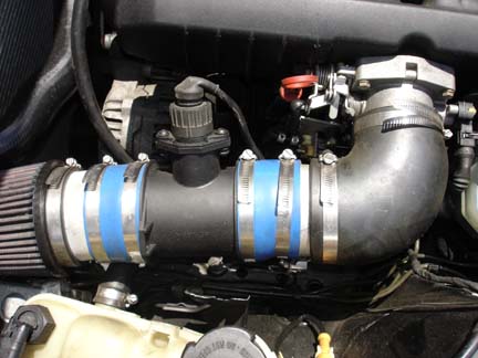

            How is your PCV hose hooked up? Stock M50 stuff? Fat hose to throttle body elbow, small hose to M50 manifold fitting?
            How are the fittings on the bottom of your throttle body hooked up? From left to right, facing the butterfly, it's coolant line, coolant line, vac line to electric check valve for charcoal canister, right? Is the electric check valve hooked up?

              How is your PCV hose hooked up? Stock M50 stuff? Fat hose to throttle body elbow, small hose to M50 manifold fitting??
              yes, it was hooked up like the stock s50......except we made some custom elbows / fittings. http://www.r3vlimited.com/board/atta...3&d=1149268632
