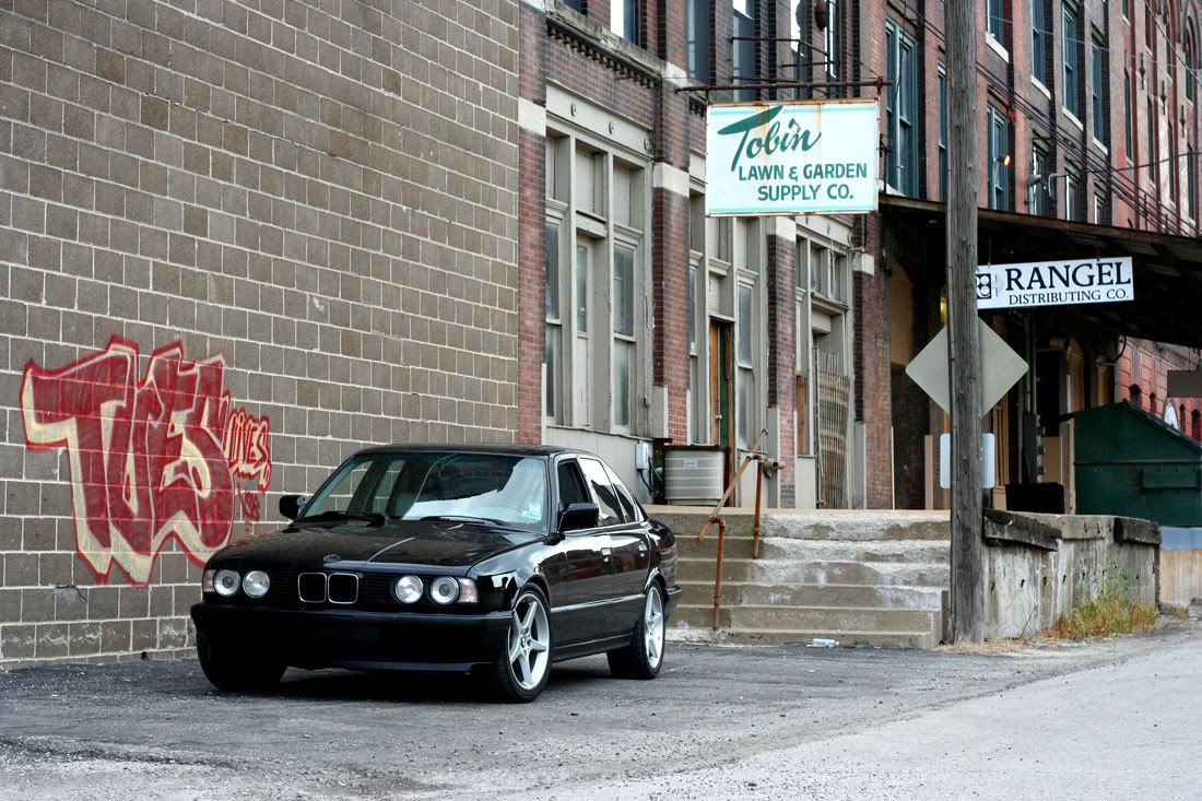

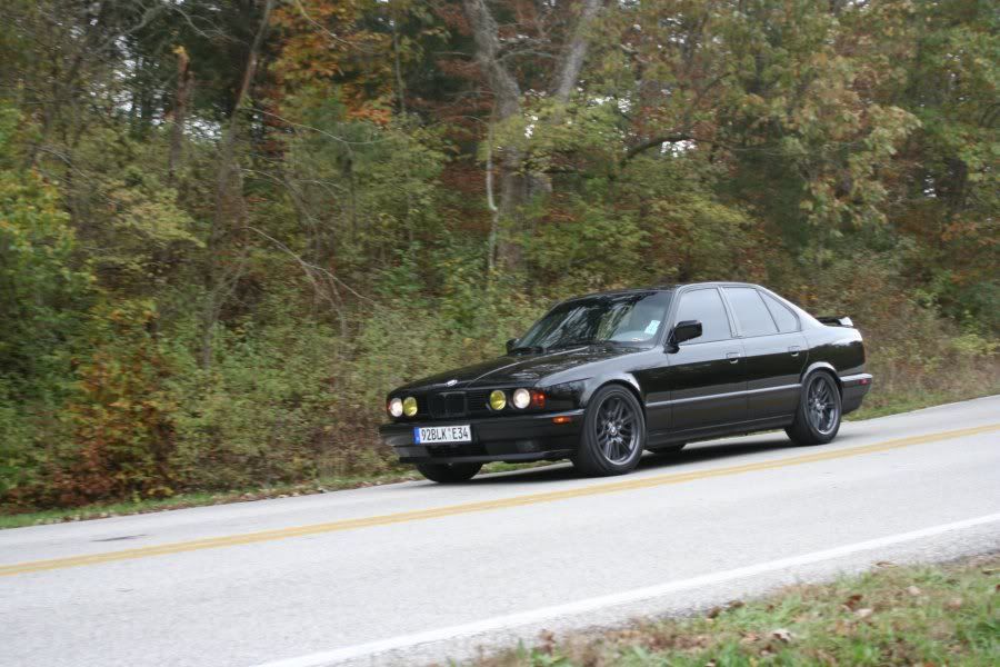

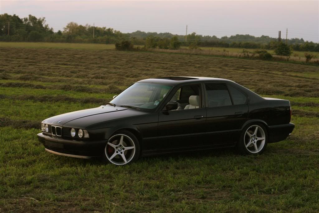

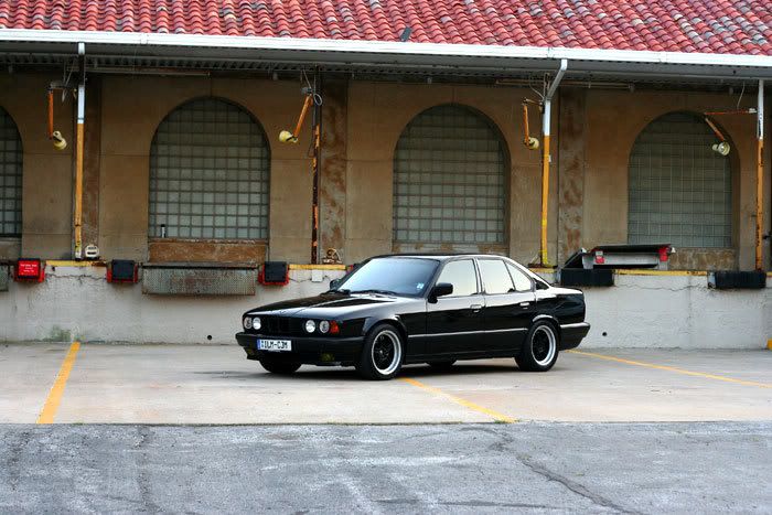

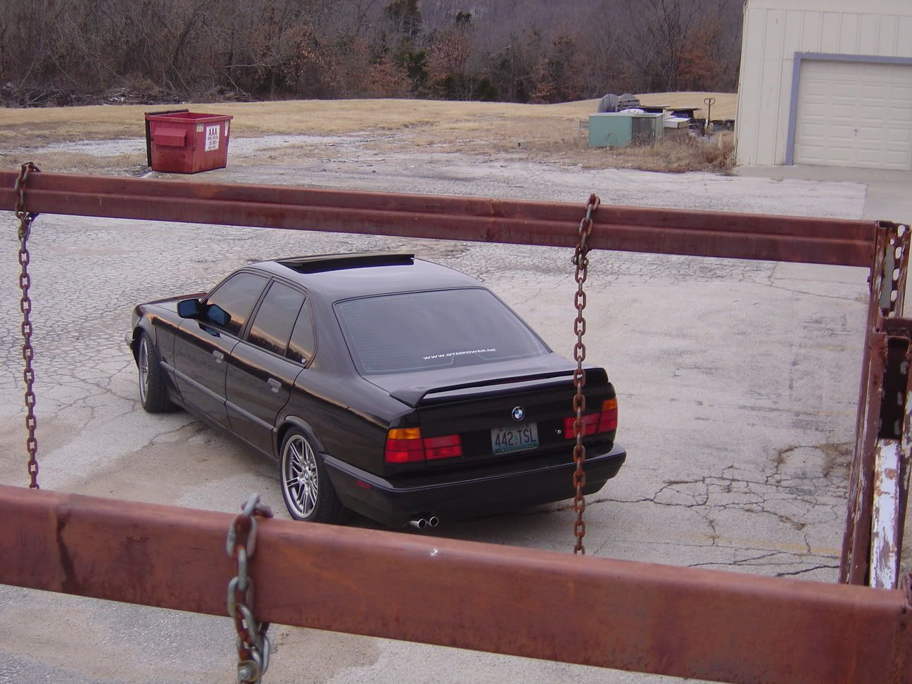

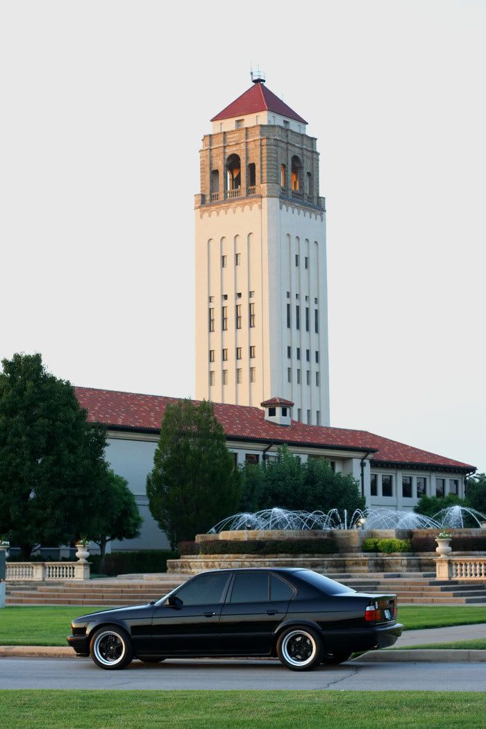

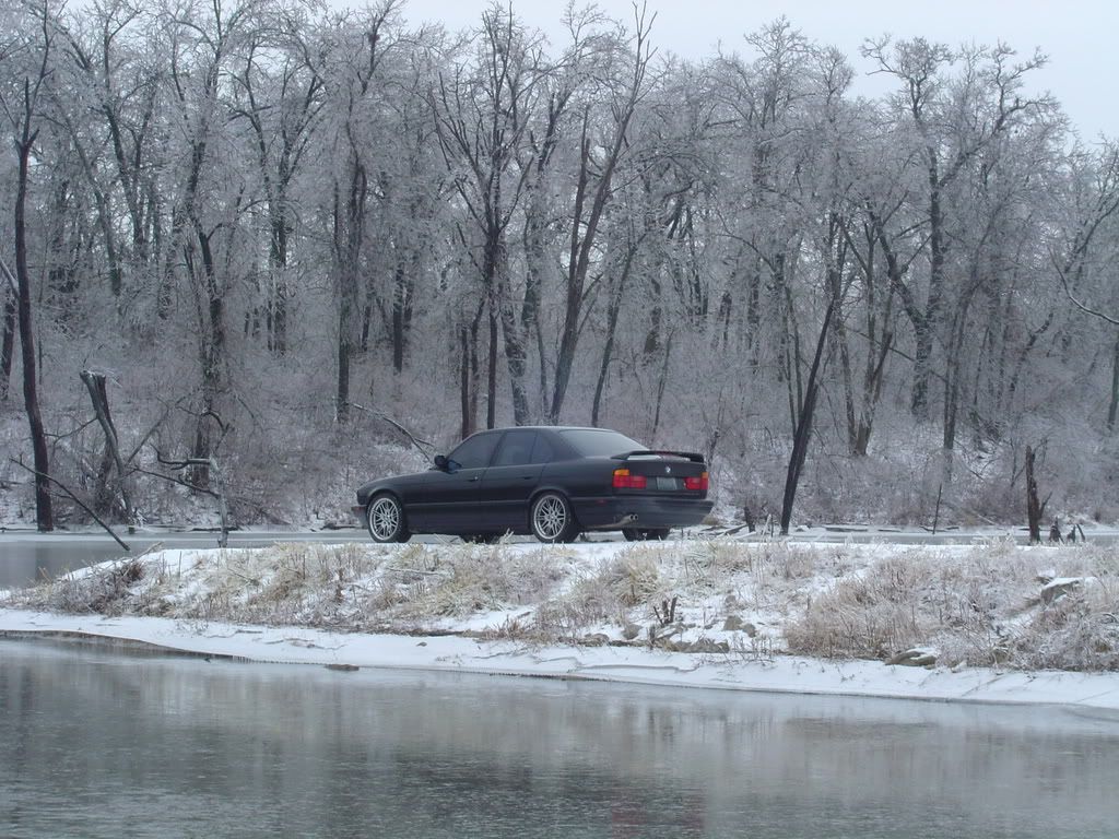

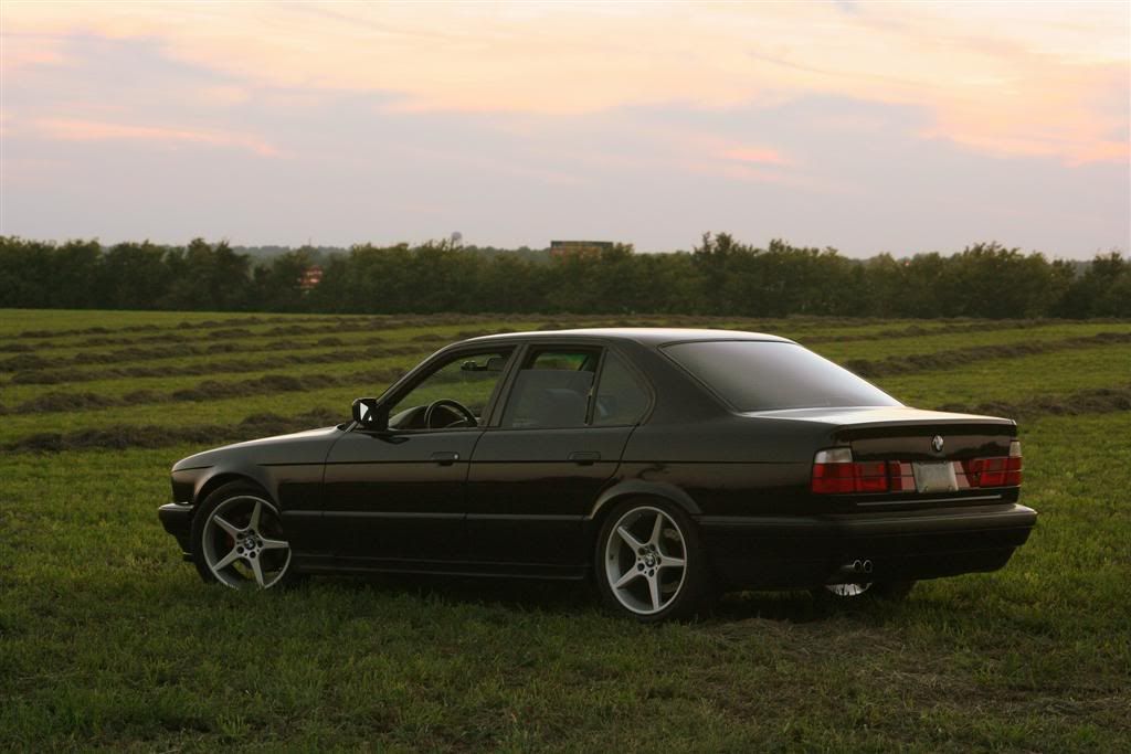

                    Heres a couple pics of my past e34's since you guys seem to be into them...

                        Absolutely gorgeous E34's. I'm on the lookout for an E34 M5 to replace my E39 right now...I need to find one as nice as yours! :up:

                          Awesome, thats what I wanted to hear. I've been on BF.c since 03 and never had much of a reason to venture out until now.
                          I just picked up a Calypso E34 a week or two ago, and I picked up a Racing Dynamics full kit for it. Gotta do some more work on it and its going to get an over all paint job when the kit goes on. Lots of other cool things in the works for it as well..
