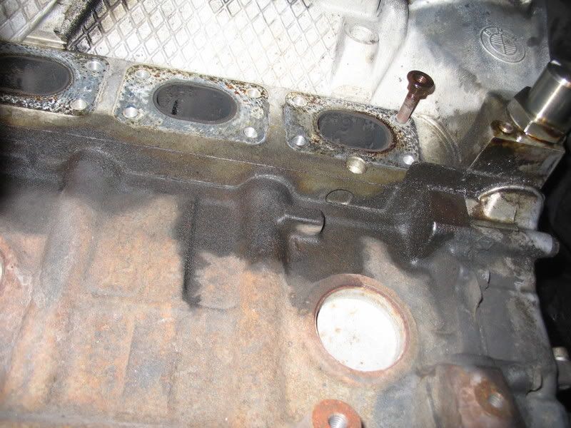

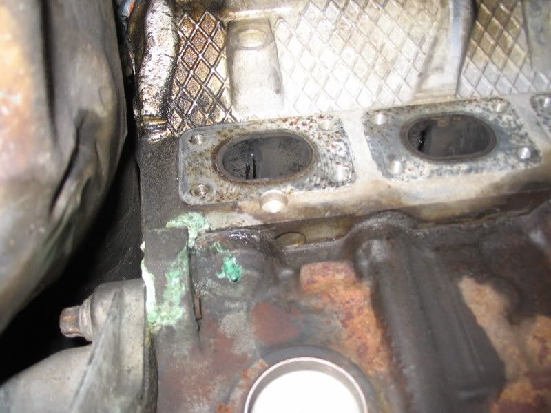

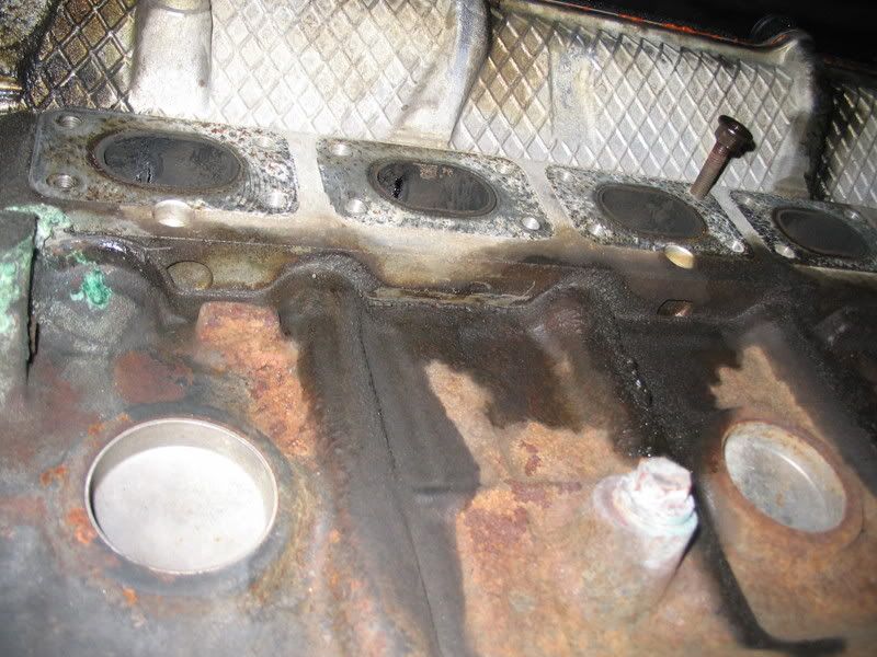

        here are some pics that potentially be HG leak. What do you guys think?
        The compression is good, haven't checked leakdown.
        Alex

          Yep, probably the head gasket starting to go.
          No telling how long you have. Probably not urgent, but be prepared.

            I wouldn't say be prepared I'd say down the car and get to it now so it doesn't cause a problem later.
            Very few people tend to check their water temp while driving on the freeway and that's where this problem could let loose.
            Take the opportunity to take care of it before it goes because it will go.
            Ticking time bomb.

              well, considering that i have just buttoned up the engine after changing retainers, seals, vanos, tensioners, etc, etc I am really reluctant to take it all apart again. Maybe next winter.
              i wouldn't call a gasket a ticking time bomb. Retainers, e36 cooling system and oil pump nut ARE time bombs
