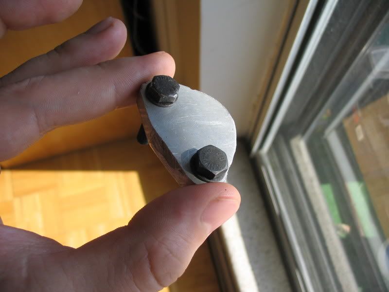

                just wanted to post pics of my ghetto diy block-off plate (cost: $5 alu plate, 3hrs of elbow grease. I'd just buy one made by professionals for $25 if i'd do it again)
                Notice the drill marks across the edge = lack of proper tools FTL

                  interesting, i'll have to look into this more as I assembly my m52.
                    Do you have any pics of how you re-routed the spider hose?
                      Hell, I'll sell you a laser cut one for $20... They're pretty too. :D
