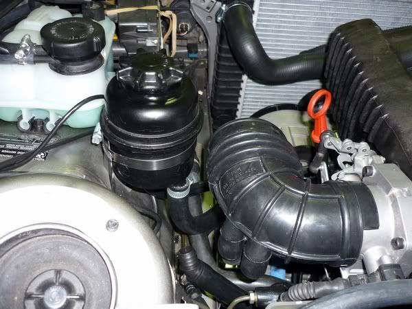

Where does everyone put their ps res?
    Don't ponder...
    Pick up the bracket from Pelican or any other online vendor and mount it on the arm (part # can be found at realoem.com). The solution is ready made from BMW and works great. No sense re-inventing the wheel.
      No place has them without special ordering. Thatll take minimum 2 weeks with shipping. I might just go to home despot and fab a bracket.

          I have to do something about my PS reservoir as well shortly...but I can only think the location on the engine arm would be a PITA to access...is this the case?
          Mine's mounted on the airbox mount for now, but has to move to make room for the E32 airbox on its way. It will be nestled comfortably behind the headlights. Easy to access and looks tidy.
          To do this you can keep the E30 res, but will have to extend the lines a bit and modify the mount, no biggie considering the 24 valves its sitting next to ;) I had to run custom lines to the E36 pump anyway.

                            Installed my PS reservoir today...it works:
