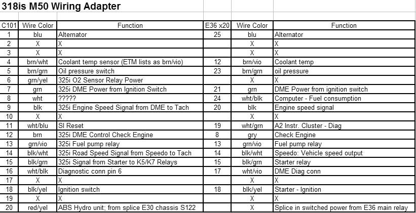

I have been searching and reading a lot so I think I have this just about all figured out.
I wanted to post and see if I have everything right or if I am missing something
I am dropping the m50 in my 318is
This is what I already have or will be getting....

Is the attached wiring diagram correct for the swap? How should I pull power for the ABS? Just tap into the main relay? Or something off the fuse box?
Do you see anything that I am missing or anything I should look out for when swapping?
