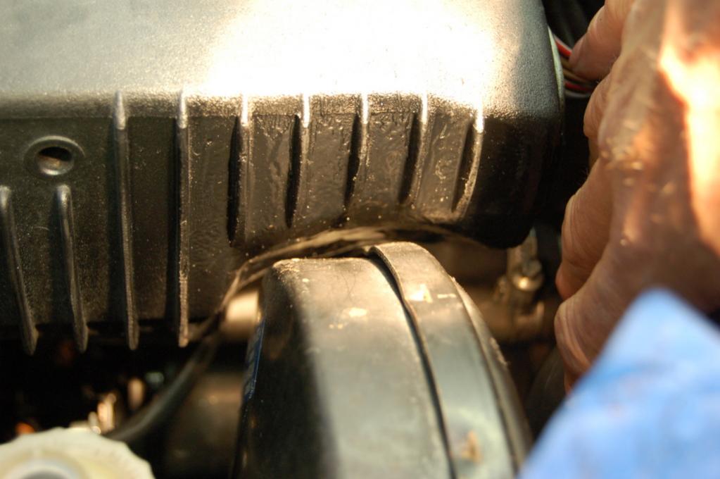

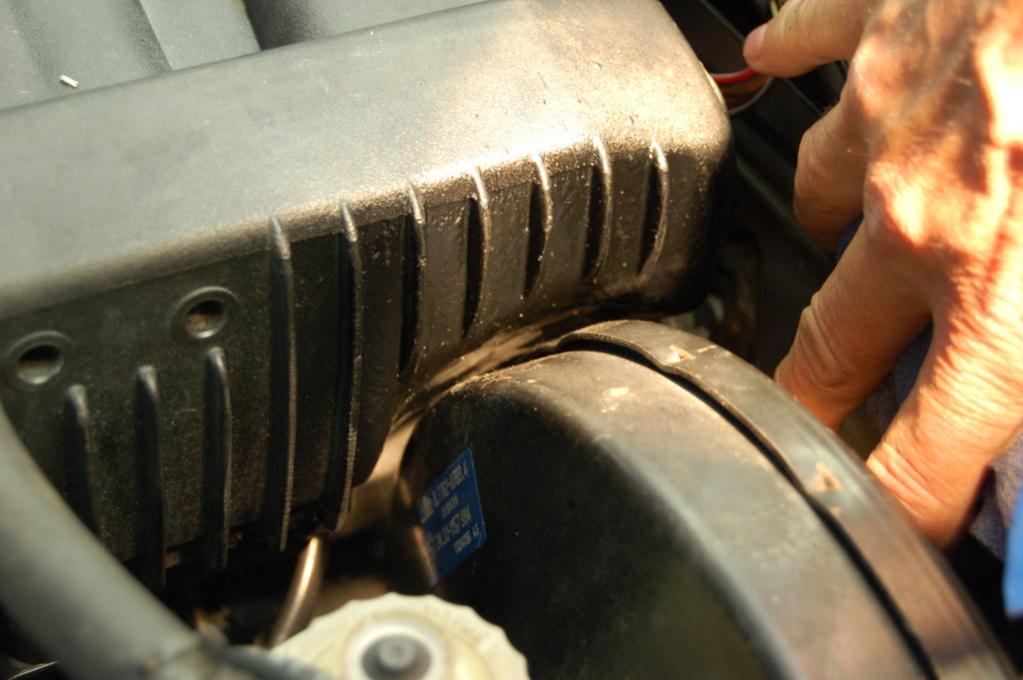

                  Yes it can be done, I hav't done this myself but I want to do to something similr with my s50 and euro intake but there will be some welding involved. I've also be told that the original brake booster is your best bet rather than changing it for a smaller one. I mean what would you rather a car that stops well or one were you saved some time getting a smaller booster???
                  Heara are some pics

                          It can be done, we just did it on our car last night.
                          Need to move it to the right by drilling new holes in the firewall ( thus weakening it but maybe marginally)
                          You will need to offset the fork. And you will need to dismantle all the pedals to be able to reach there to bolt it in later.
                          It's a major bitch man compared to getting an Ix booster and swapping it in.
                          Although I have around 1/4'' of clearance without spacers and without shaving the manifold.
                          I have an OBD2 manifold though so i don't know if its farther away from the booster.
                          So yes it can be done. Is it worth to save 200$. For me yes, but mileage may vary.
                          There you go.
