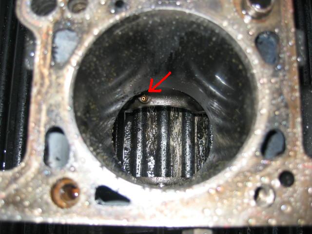

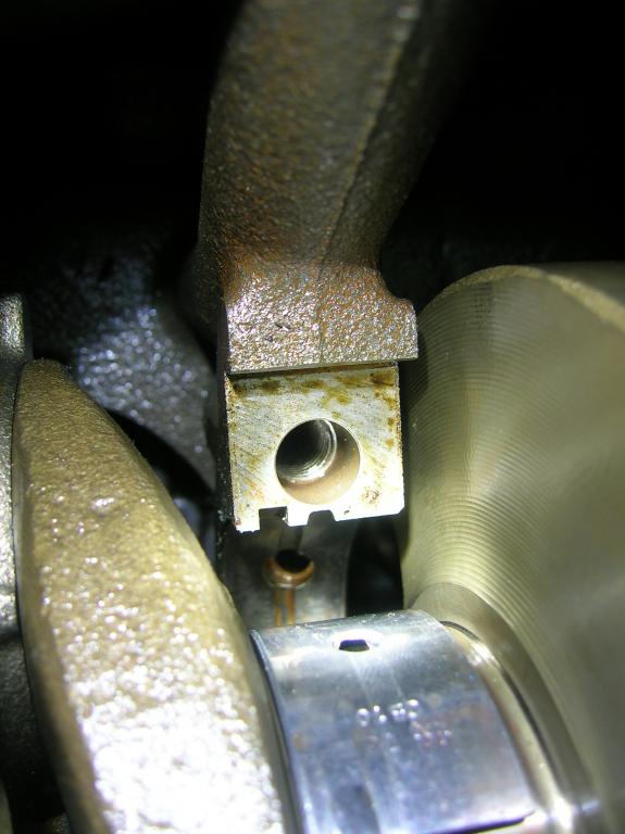

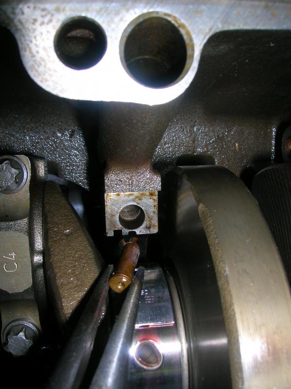

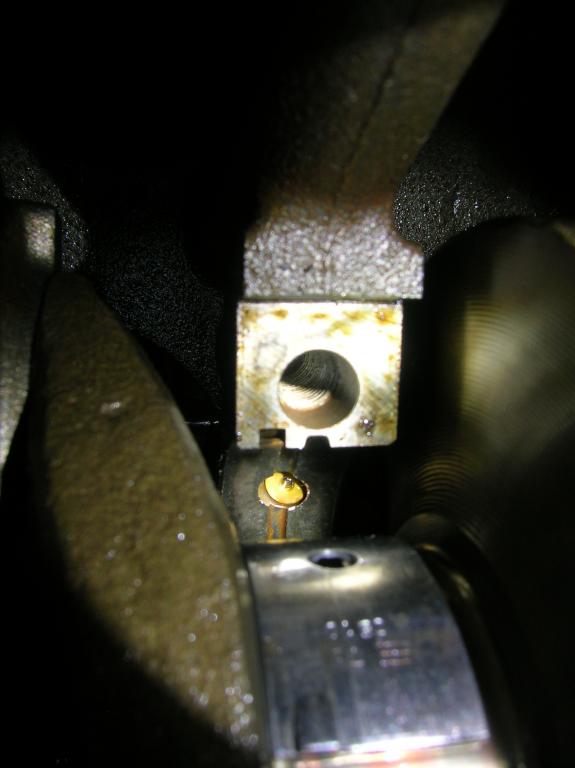

    I made some progress and got the bottom end together but then realized that I forgot to install the oil sprayers. Is there any way to install them with the crankshaft installed? I am not looking forward to purchasing $200 in hardware for this F-up...

                  I took out the main cap bolts and taped the pistons with a rubber hammer while a helper pulled gently on the crankshaft and was able to get enough room to remove the bearings and get the oil squirts in. Great idea thanks for the help !!!
