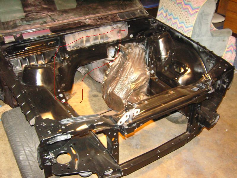

    Hello,
    I'm painting my engine bay, and I'm wondering if I removed my old worn out engine foam; is it imperative if I don't put it back in?? This car is my daily driver. Would there be too much heat resonating from the engine coming up through the dash?
    (I'm at work so I don't have pics of my car, but when I get home I'll add actual pics of my car. But this is too give an example)

    You will get a lot more engine/tranny noise.

            You can remove the insulation safely without a noticeable difference in cockpit noise. My brothers M3 had no insulation and engine noise was by no means excessive; a negligable difference from my 318is (with insulation) and an almost identicle engine/exhaust setup.
            The plus-side of removing the insulation is the ease of transmission removal if/when you need to change the clutch. It makes getting at those upper tranny bolts much easier.

                I knew the quilt on the chair in the OP looked very familar. That's my car. I bought all new stuff, at dealer discount I think I spent 80 bucks or so.

                  X2!! it took me 30 mins to drop my trans last week, i think that was my fastest time.

                    I hope you didn't mind using your car. I swear it'll be the only time!!!
                    So there isn't a real difference then?

                          agreed. ive always taken mine out. also, the insulation traps moisture against the top of the tunnel and will cause rust. ive seen a few "rust free" cars with rot hidden under the insulation.
