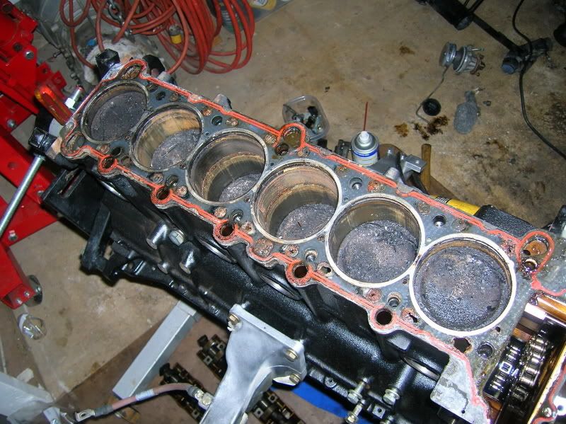

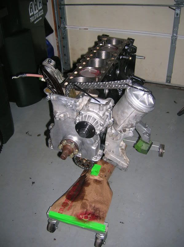

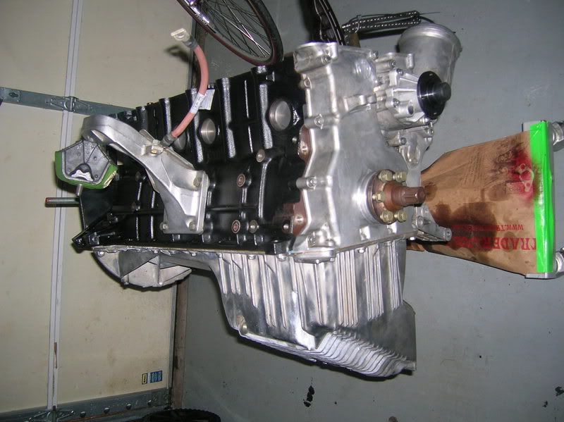

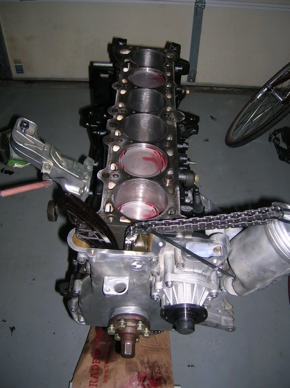

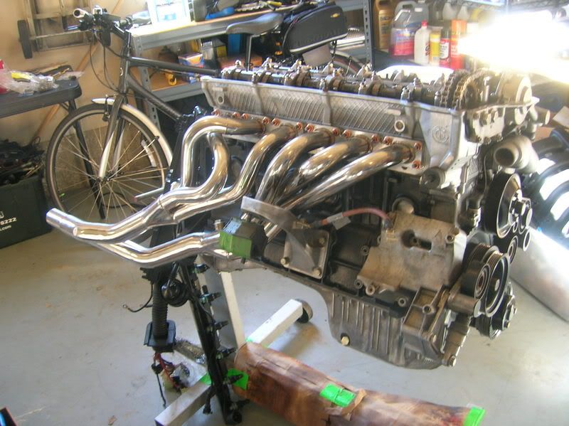

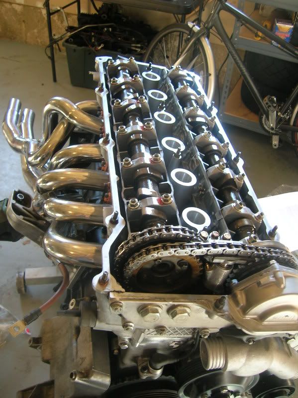

    My S52 has been sitting in pieces for almost a year so I decided now would be a good time to finish the rebuild.I finished work on the bottom end. New rings,Main bearings,rod bearings etc..In the next 2 weeks I am going to finish the top end and should have the engine complete. I would like to have the engine in before November.
    BEFORE
    AFTER

      Yikes. Did the engine turn over easily in this state? What led you to take the head off?

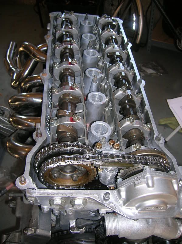

        I love how your timing chain is zip-tied to the filter housing
        good luck with the deadline, looks good so far! Keep us posted!

                      Meh - that is nothing. If you spit on your finger and ran it up and down the boar, the rust would come off to show the original cross hatches from the factory. Looks way worse than it is - not to say that a motor sitting untouched doesn't get ruined.

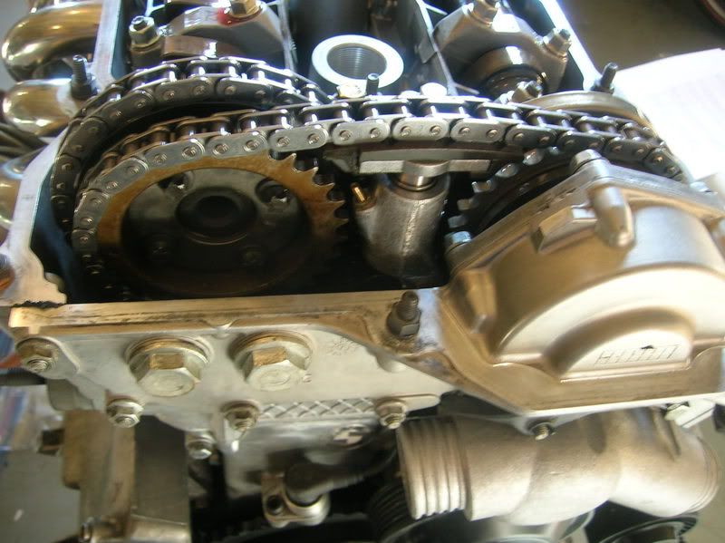

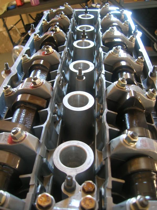

                          I got the head on cams and VANOS installed. I just need to go back and double check everything is correct and the engine should be done. I am not going to meet my schedule going out of the country for work...
