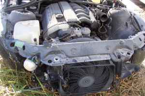

    well, there she is. now it is official because it is sitting behind the fence in my back yard. what the hell.... 47,000 miles on the odometer. I am very sure that is the correct amount. the previous owner and i jump started the engine today and it sounded beautiful. i opened the oil cap with it running. there was not a hint of smoke or hesitation. the engine seems very tight. haven't done a compression check yet. I plan on using the engine(of course) and differential from the drive train. the shifter too. the suspension on the pax side seems to be trashed. the struts may be ok. if they are, i will try to use them as well. the trailing arm and rotor on the right rear are scrap. on the front end, the bushing that holds the lower control arms to the chassis are missing on both sides. someone actually welded them to the body at some point, but both welds have broken free. all of the m brake calipers are in good condition. i would like to use them if they will bolt up to my stock 4 lug setup. the power steering rack is missing(dammit!). looks like the front end is a bit tweaked. the motor mount bracket on the drivers side is broken. the radiator and condenser seem to be ok. looks to have been a rather wierd accident. both fenders and quarter panels are in good shape. i had to cut the door hinges on the pax side door to get it open. this car came with some really kick ass heated leather seats. they are black and grey and look narrow enough to fit the e30. the power seat track looks wrong and also they won't flip forward to allow passengers to climb into the rear. i sure would love to use them though. i was thinking of taking the tracks off my stock seats and see if i can make them work without the power option?

                      i jacked the car up on cement blocks today and crawled around underneath. the unibody in the engine compartment is tweaked such that it appears someone replaced the engine crossmember but since it is too long due to the accident, they just welded to the frame on the driver side. yes, the motor mounts are both broken. they look like someone ran the ends through a meat grinder. the oil pan on the engine has most certainly been replaced. all of the drive train components look like new but the oil pan is still shiny. the aluminum cover plate on the diff is trashed. the mount that protrudes from the left side is broken off. also those nifty fins on the lower portion of the housing are broken off as well. dammit! i tried to remove the diff today, in fact. the carrier frame that holds the rear end together is bent such that the two bolts on the top are up against the body and impossible to get a wrench on. i will have to bring the torch over and cut the bolt heads off. the diff is likely still ok to use, but i will have to replace the cover plate. happen to have a couple e 30s laying around. for now, i plan to keep the trans until i do a little more research and decide what i am going to use. still leaning toward the getrag, though. the front rotors have been replaced since the accident. and they are new. front struts have been replaced used and they don't match. one is a yellow bilstien with a blue coil spring. the other one looks like it would have come from the factory. as i mentioned earlier, the power steering rack is missing and the steering wheel is spinning into oblivion. both (front and rear) M stabilizer bars look good.
                      the balance of the car that i am not going to use is certianly for sale. color is cosmoschwartz metalic with black and grey leather. the interior is really nice, but for now at least i am going to keep the seats. the stereo is missing, and i am planning to keep all of the harmon kardon premium stereo components. needless to say, all four airbags are blown. the convertable top is very nice but the plastic rear window is hazed from sitting in the sun for a couple years without care. both front fenders are good, driver door, the rear clip is nice with a fixable dent below the gas cap door and there is a small tear about 2 inches long in the rear valance by one of the exhaust outlets. its a shame the car suffered so much damage. i really like the extra flare on the factory m quarters. speaking of which, does anyone know of a z3 forum where i can advertise these parts?

                              well, i already tried cutting trough the floor in the trunk as far forward as i can reach. i made a small slice with my angle grinder where the horizontal metal meets vertical. unfortunately, this spot is about 3 inches behind the area i need to get to. in the passenger compartment, i drilled a hole in the area behind the seat. that one is about 5 inches forward of where i need to be. bastards!
                              keep in mind the car is a 47,000 mile southern car. nothing is rusted or corroded. if i washed off the dust and dirt, i could eat off the bottom of the car it is so clean. since there is a long spacer between the subframe and the bolt head, there will be about 3/4" still sticking out of the hole. i can just grab a hold of the bolt shank with a pair of vise grips and turn them out. the last thing i want to do is go underneath the car with a smoke wrench. i envision that as garbage truck mechanics, but i am out of options unless someone has any better ideas.
