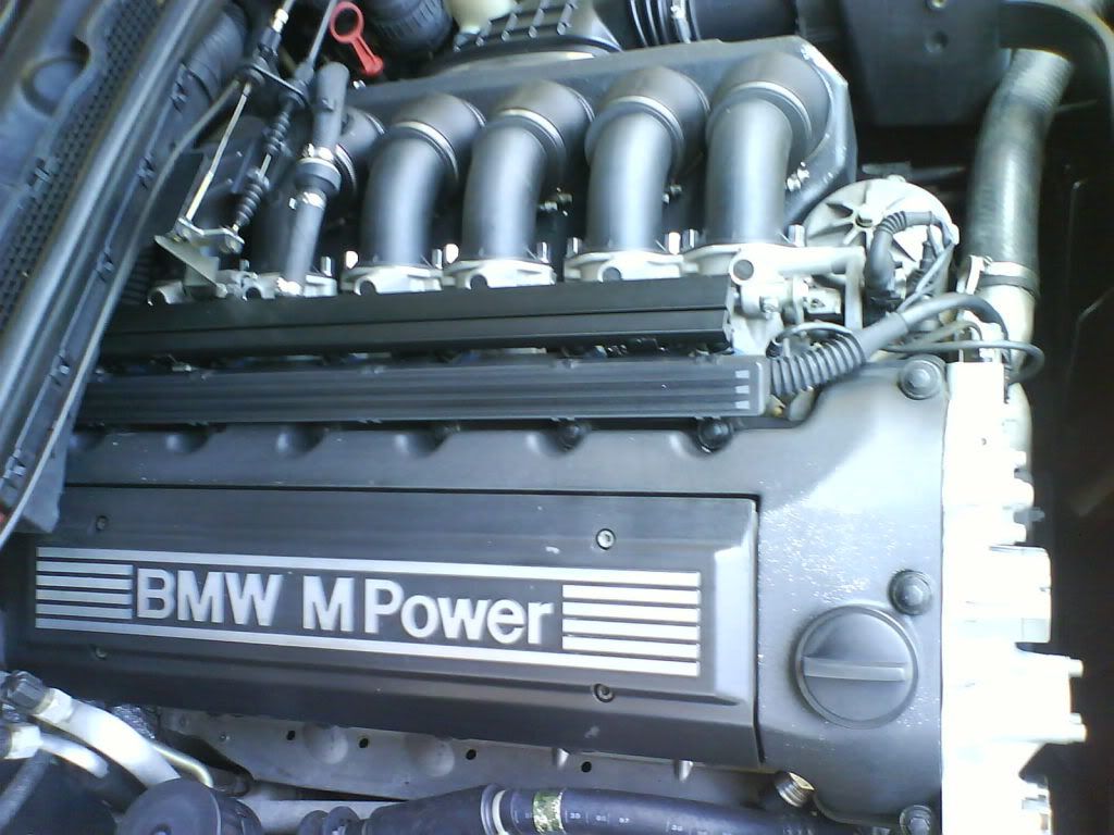

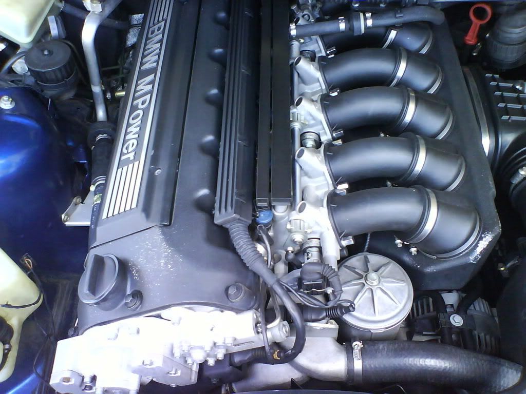

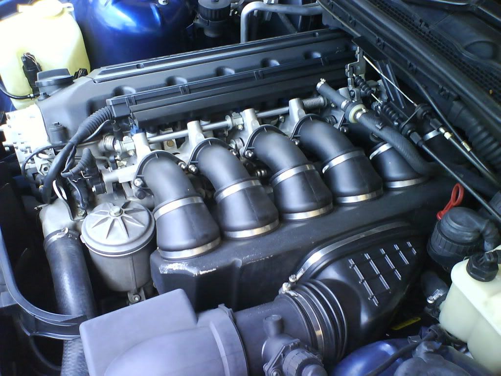

    Please help me identify what motor i have, all i know is that its 3.2l and has a 6 speed tranny.....
    this is the motor im gonna use for the swap
    any info will be much appreciated
    please help guys
  • e30s52
    • Oct 2007
    • 5235
    euro s50b32

                  Like I told you in another thread, it is not OBDII. OBDII late in the 90s was a US only thing.
                  Really, trust me on this one. I have an S50 B32 and more specifically I have a South African spec S50 B32.

                          OBD(-II) is short for On Board Diagnostics, which is a US EPA standard for accessing stored information on engine operation and related subsystems, with the goal of being able to access this information across all car makes and models through a universal connector.
                          The "World" engines do not have OBD as implemented in the US, as Bruce has mentioned.
                          To be accurate, the S50B30 (Euro and elsewhere) uses a Bosch M3.3 DME. The S50B32 uses a Siemens MSS50 DME. The different DMEs will determine what pins need to go where when grafting the E36 harness to the E30, either directly or through an adapter.
