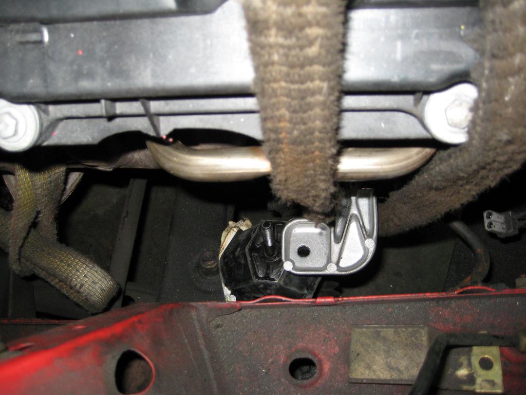

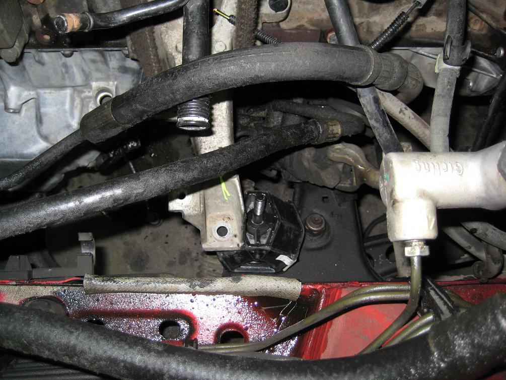

Allright I have my motor almost in but ran into this problem. It needs to go back about 1.25" to sit onto the motor mounts, but will not because the shifter linkage will not go back any further. What am I missing ?
Car: 1991 318is
Motor: m52
Trans: 240
Mounts: I think from a 535 or somtehing some one on here gave me the part# they look right just got to get it back about another inch.
Do I need different linkage or do I need to shorten mine ?
