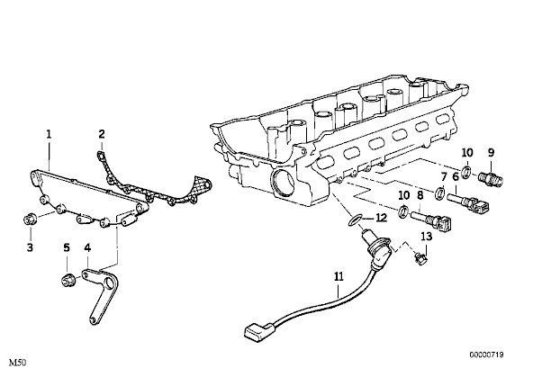

    which coolent temp sensor?
    Ok so Ive been searching and cant find out a few things
    What sensor needs to be replaced on the m50 one closest to front of engine or one closest to rear.
    and can i get the part number of the sensor from the m20? that i need.
    Thanks for any help I have been looking and cant find a definite answer
  • chuck90m3
    • 568
    Replace #6 with,
    PN 13621357414
    TEMPERATURE SENSOR 20CEL 2500 OHM
