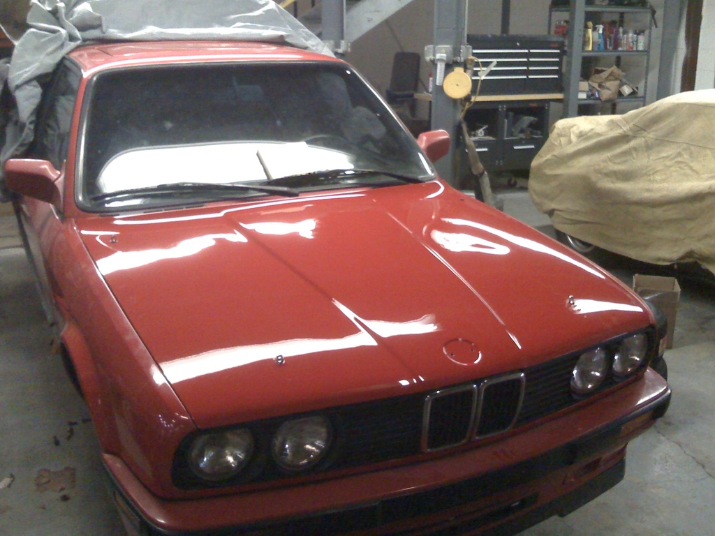

    Took a couple coats of fill and sand to make this hood look this good. Bought it super cheap, and spent about 6 hours total on it. Friend of mine hooked me up with the paint. The hood came with a fg sunroof panel as well. Bought it locally, no idea who made it, although I think it came from Moseley Motorsports. Fit and finish is actually really good. It weighs 7lbs. On the same scale the stock hood weighed 29lbs.
    It literally embarrasses the rest of my car in terms of paint quality. the rest will be painted by the end of the calendar year. Should be an easy paintjob, the body panels are all nice and straight. He's good too, won't take long at all
    Sorry for the shitty pic, took it with my 2mp cellphone.
    looks great. can i see your pin locations? and the bottom side of the hood?

        Fit looks alot better than the IE race hood I had.

                  7 lbs VS. 29 lbs!!!! :shock:
                  May have to buy one of these, how much did that bad boy run you???
                  INSTAGRAM: @UNDR8D_EMPIRE
                    found it locally for $150. Was a little damaged, but only took me about 4 hours to repair and prep for paint, basically two 2 hour stints after work one day.
