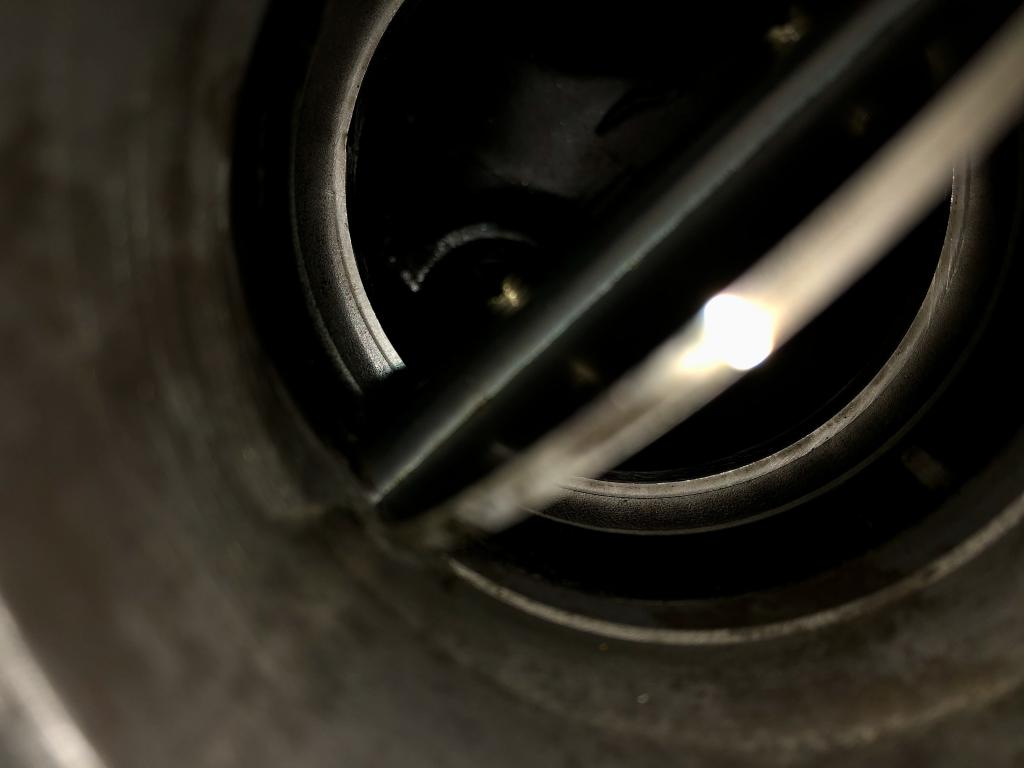

              Originally posted by ZekeTheSneak
              Peak in there and see if it's overlapping? Might help to take the sharp angle off the plate with a file or sandpaper.
              Sure enough...the opening in the throttle body plate is about 2mm smaller in diameter than the throttle body inner diameter. Seems like that could possibly create enough turbulence to make noise.
              • ZekeTheSneak
                • 1562
                Yay wahoo hopefully that can be adjusted
