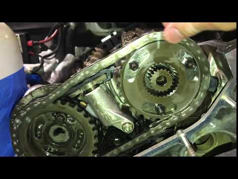

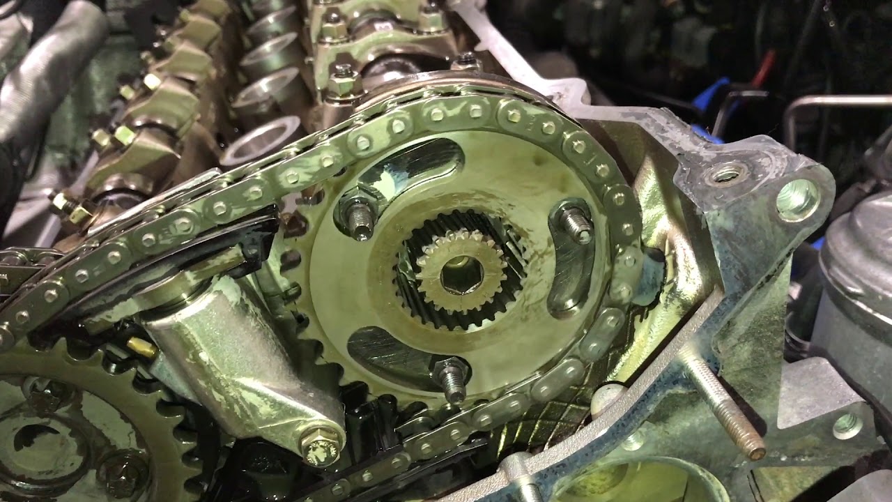

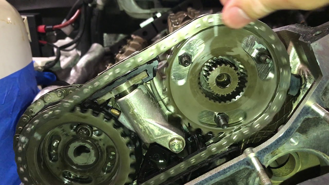

    This is how I found the Vanos sprocket at full lock -
    Click image for larger version  Name:	IMG_FULL_LOCK_WRONG.jpg Views:	0 Size:	77.0 KB ID:	9936480
    Vanos Rotation ( before & after videos )
    Before ( how I found it )
    After ( appears it was off a tooth )

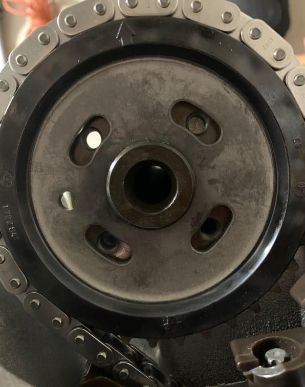

    Main Chain ( before & after )
    Click image for larger version  Name:	IMG_ORIG.jpg Views:	0 Size:	78.9 KB ID:	9936481
    After ( from what I read has to be to left not center )
    Click image for larger version  Name:	IMG_FIXED&MARKED.jpg Views:	0 Size:	76.4 KB ID:	9936482

    It appears you assembled it wrong, referring to the last pic you uploaded. You need to set tension on the MAIN timing chain, and center the exhaust cam sprocket exactly how it was before you took it apart. Leave it alone at that point, your done. You on the other hand turned the sprocket "All the way to the left". I doubt it would affect engine timing how you have it installed but I sure would have assembled it as it was since you NOW have it assembled a "few teeth off". Take it back apart and do things right.
    You seem to be getting the term "Cam timing" mixed up with "VANOS timing". Right now your main chain sprocket isn't clocked properly. Fix that first then go onto installing the VANOS sprokets/ chain.

        Are you sure I timed it wrong ? ( maybe were both right in different situations ) I didnt move it all the way to the left, I moved it backwards one-tooth to match the guidelines for reusing your timing chain.
        Im aware of the video above ( the commenter right at the top of it "M3NACE" has a ton of DIY videos ) and is the one that vouched for it to the left of the bolt hole..
        Video - https://youtu.be/O1gVskqp2Xc?t=291​
        Also FCP's blog post here [ https://blog.fcpeuro.com/how-to-set-...s50-s52-engine ] States :
        Click image for larger version  Name:	FCP2.jpg Views:	0 Size:	33.3 KB ID:	9937435
        Heres the picture of their chain sprocket in the DIY from FCP ( looks to match mine )
        Click image for larger version  Name:	FCP.jpg Views:	0 Size:	85.6 KB ID:	9937436

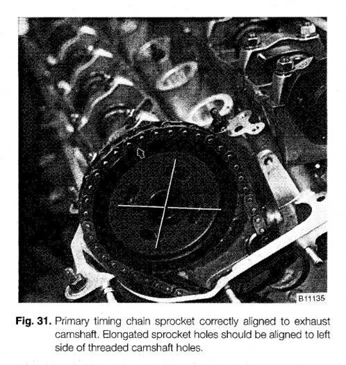

        From the Bently Manual ( page 108 )
        Please confirm if you still think mines wrong ...

          I personally would have centered it but like I said, doubtful it would affect engine timing. You tighten that sprocket to spec when everything is at TDC and once it's tight that's it. That sprocket isn't going to move anymore. Did you pre-tension the timing chain before tightening that sprocket though? The sprocket moves a bit when you tension the chain. It's usually a tad bit off but once you put tension on the chain they'll center to the slots in the sprocket.
          All I can say is you definitely should take it all back apart and rotate that sprocket one or two teeth over if you didn't pre tension the chain.

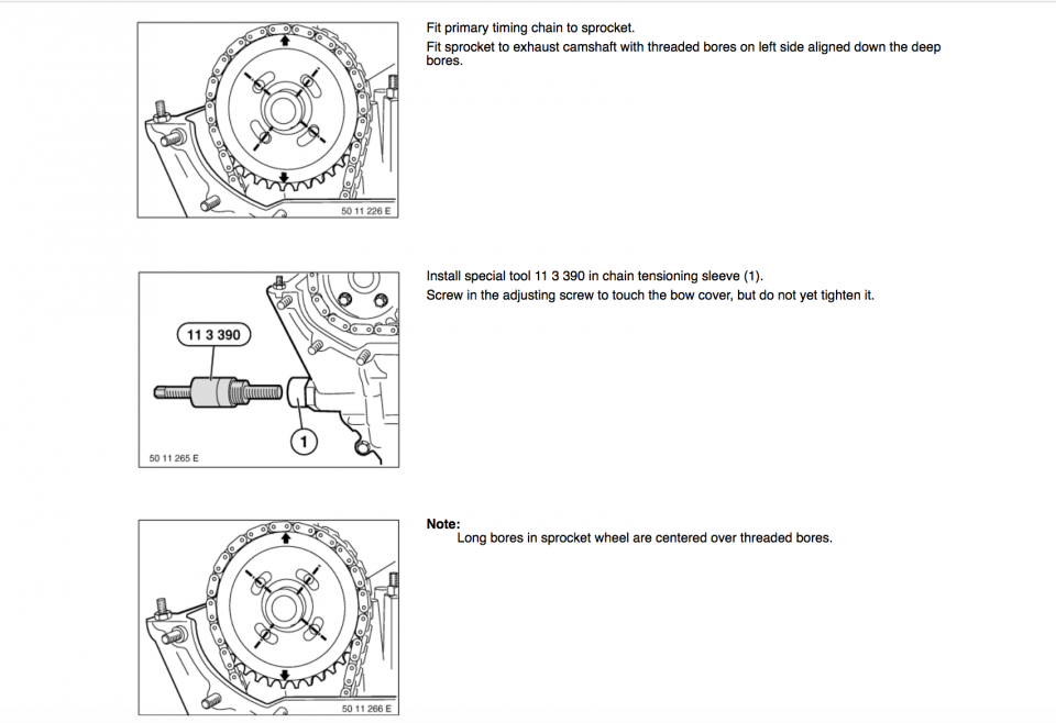

            Here's a screenshot of the official BMW instructions we have at our dealership showing how to install that specific chain sprocket. They want you to start with the holes slightly off like I was saying earlier and once you tension the chain, it will center on the sprocket. I personally wouldn't take into account the "chain stretching" / stuff your reading online. That's a guessing game.. it's anyone's best guess how much the chain has stretched over 20yr of use. Besides, setting pre-tension on the chain before tightening the sprocket down takes that into account.
            1992 e34 Touring- S50 Swap
            1992 325i-S50 Swap (SOLD)
            1991
              THANK YOU!! Pictures help... Its just confusing at first, From your BMW instructions it sounds like you align it left how I put it, then the tensioner tool pulls it into the middle ( it doesnt move that much ) so if the ultimate goal is middle ill put it back to where I found it.
              Im not to that point yet ( my head isnt back from machine shop yet, Just ironing out the steps so theres no suprises when the time comes in a week ).
              ILL MOVE IT BACK 1 TOOTH ( Thats the only change I made for the rear main gear )
              I was only marking everything for disassembly and when I saw it centered I thought it was wrong, I found it like your last picture in the sequence and thought it was suppose to look like your picture in the first sequence.
              Steps from what I gather :
              1 - Put cam-gear back 1 tooth ( thats where it was originally and will be centered )
              2 - Set dummy tensioner finger tight which will move that gear a tad ( this will stay like this until the full vanos setup is complete and then replace with real tensioner )
              AT THIS POINT THE MAIN CHAIN STEPS ARE DONE
              3 - Move onto the rest of the vanos install steps which Im pretty sure I understand 100%.
              Before ( how I found it, didnt have full spectrum movement side to side )
              After ( now has full movement )
              The way I found it wasnt allowing it to have the full spectrum of movement end to end and now it does ( all 4 bolts can be in as well and same rotation works ). Pretty sure I follow how this part works.
