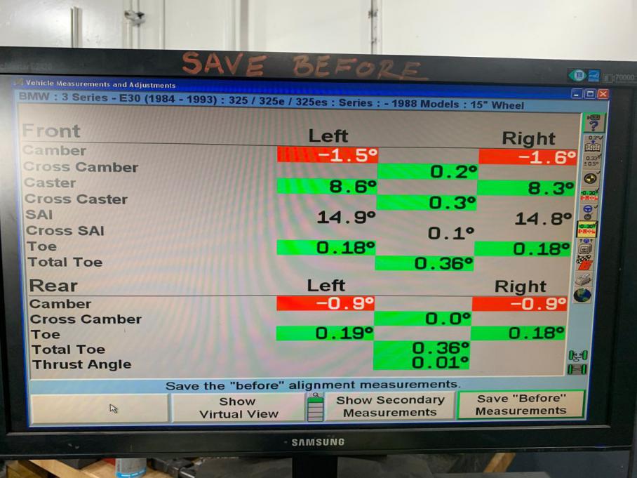

    I went for a slightly aggressive street alignment. I have stock suspension so it can't be adjusted much. But I did replace rear subframe with Garagistic adjustable subframe which allows for rear camber adjustment.
    Front: -1.5 degrees camber, +8.6 degrees caster, +0.18 degree toe
    Fear: -0.9 degree camber, +0.19 degree toe.
Name:	2019-09-03 - e30 wheel alignment.jpg
    When I had stock M20 with stock rear subframe, condor engine mounts, ireland engineering green poly (95A?) subframe bushings, the car was very nimble in the canyons and I never had alignment done on the car since I bought it. The car was also super noisy and harsh. I haven't tried canyons yet since my swap but now I also have softer AKG 70A motor mounts and 80A subframe bushings.
