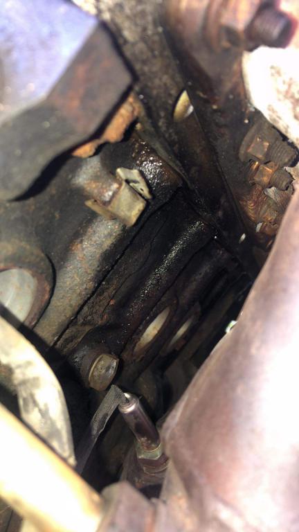

So i recently swapped my car with an S52 with around 200k miles. I cheaped out and didn't reseal everything on it. When i pulled the engine from the m3 i noticed an oil leak right in the middle of the block coming from the head on the passenger side. I tried to find the leak, but was only able to trace it to the mating point between the head and block. It is thickest near where the center three return oil galleys are. I replaced the VC gasket and put RTV in the 6 spots. I have felt around the VC gasket and it's dry. I cannot give an estimate of how much it is leaking as i just finished the swap.
Is there anywhere i am missing or is it the head gasket? There are no other head gasket symptoms and compression was 180 +/- 5 across the board with a cheap HF compression tester.
I am trying to avoid doing a head gasket as i am getting swamped with class and do not want to leave the car headless in a parking lot for too long.
