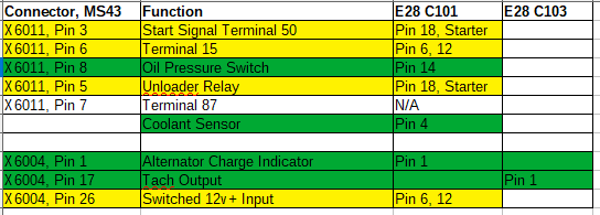

    Using Jordan's M54 thread (https://www.r3vlimited.com/board/for...m54-swap-guide) and E28 goodies S54 Swap (https://e28goodies.com/insert-some-savage-plastic-here/) as my main references as well as going through the pinout schematic I put together a wiring diagram that I need some feedback on. The rows highlighted in yellow are the ones that I have questions on

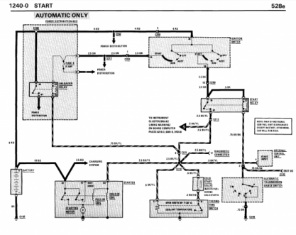

    From Jordan's thread the Unloader Relay and Start signal for the E30 are on separate circuits however on the E28 they circuits are tied together. So would I just tie both pins to C101 Pin 18?

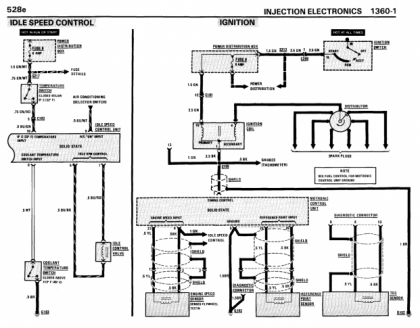

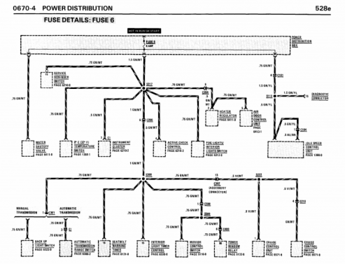

    X6011 Pin 6 and X6004 Pin 26 need switched 12V and I believe I've found them through pins C101-6 and C101-12 with Pin 6 coming from a fused source. I just wasn't sure what the difference was on the X6011 and X6004 side in terms of which to connect to.

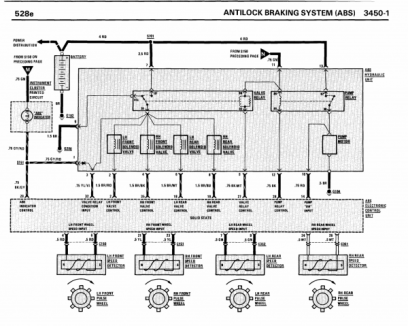

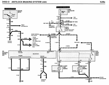

    Another question was the ABS (X6011, Pin 7) from the schematic it doesn't look like it's tied into the main harness of the E28 so would this be necessary?

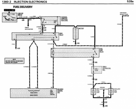

    For the fuel pump if C101 Pin 7 is left undisturbed could pin 20 of the ECU be tied into X6004 Pin 10?

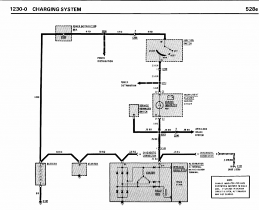

    Alternator

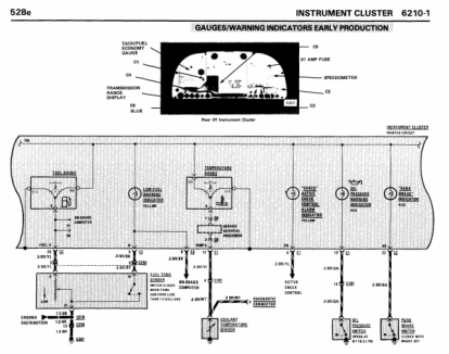

    Oil Pressure/Coolant

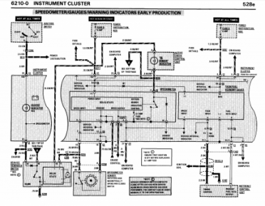

    Tach
