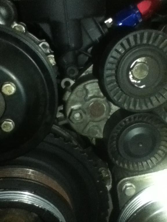

    just installed the oil housing on the m52 block, now want to know which tensioner with alternator pulley do I run? s54? Or are they interchangeable with the m52?
    Any help please

      I am pretty sure they are all the same.

        I just tryed the m52 tensioner and it almost hits the idler pulley. What am I doing wrong??

          Thats not a idler pulley. The idler pulley is offset
            u r not doing anything wrong, they will touch without the belt on, when the belt is installed the belt will put tension on the tensioner n it will b ok
