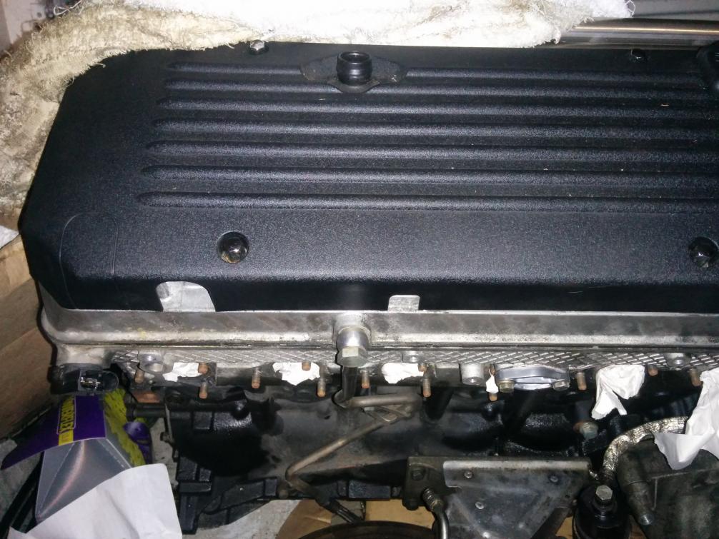

    S54 Head oil drain with E34 sump
    What is everyone doing with this, Re-routing it somewhere, if so where? Looks too important to block off.
  • FredK
    • 14762
    I hooked it up to my drain plug.
    The stock E46 pan uses a drain fitting that has the same threading as the drain plug on the E34 pan.
    It's probably not ideal, but that's what I did.
    • BMWfanz
      • Dec 2013
      • 46
      I've used drain plug and fittings
