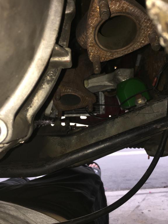

        • ykarabala
          • Oct 2014
          • 90
          #34
          Excellent thread, love the pics, and easy to follow!
          Curious to see what you'll do for exhaust.. I have the same issue of the headers getting too close to the subframe with my S50/Zf e30. I'm running the Revshift engine mounts but gonna swap them out for the e28 m5 ones and check clearance. I have obd1 downpipes modified to fit the swap but clearance issues are preventing me from installing them.
          • dude8383
            • Jan 2005
            • 10387
            #35
            You will need to have that section massaged to fit OR have it re-welded. There's no way you'll be to just bolt up the stock midsection.
            Or you can go the ebay special route and install some supersprint reps. That will require welding as well...
