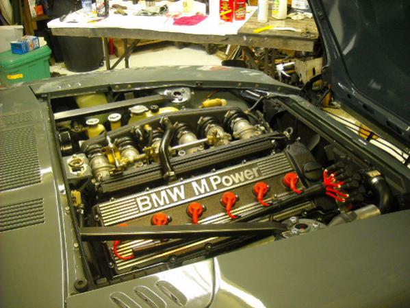

              Well I hope I don't get kicked off the forum but I'm planning on putting the S54 into a 1972 Datsun 240z, I have an S38B35 in the 240z at the moment which is wonderful but after I started reading up on the s54 it was pretty obvious that it really is the ultimate straight six.

                That will be a pretty killer build. One of my favorite cars of the era and a great motor!
