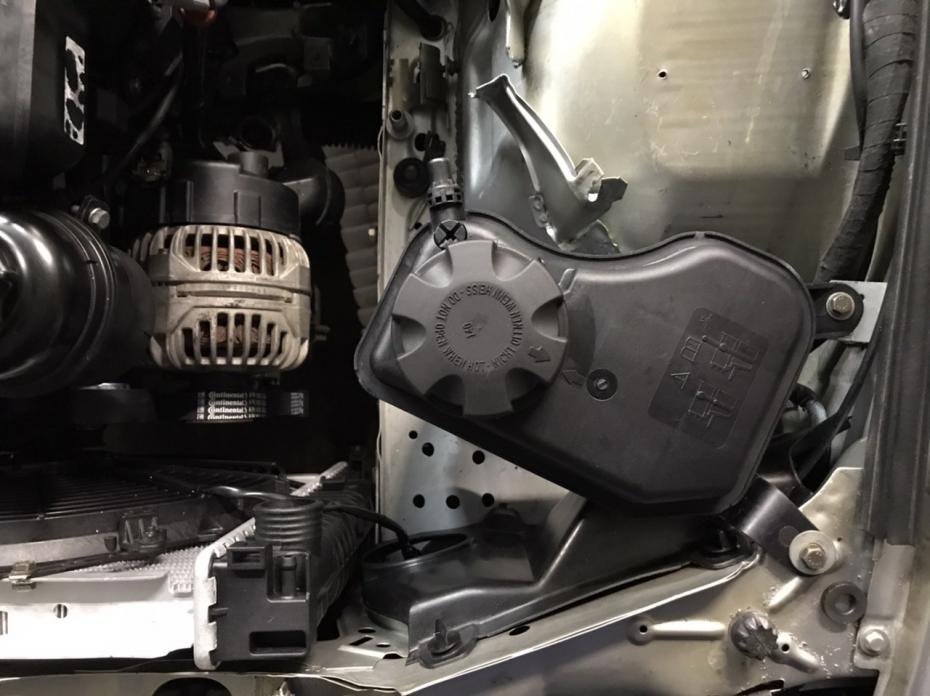

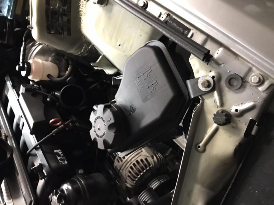

I was able to get it to work with this swap. I like the e90 reservoir for the quick release type hoses and it has a bleeder screw. I used an L-shaped metal bracket from Home Depot for the lower mounting point under the fender and secured the bracket using and m6 nutcert. For the upper mounting point, I used the same size nut cert as well. The reservoir is mounted high enough to where the bleeder screw and overflow inlet for the small hose next to it are higher than the overflow outlet port on the radiator.

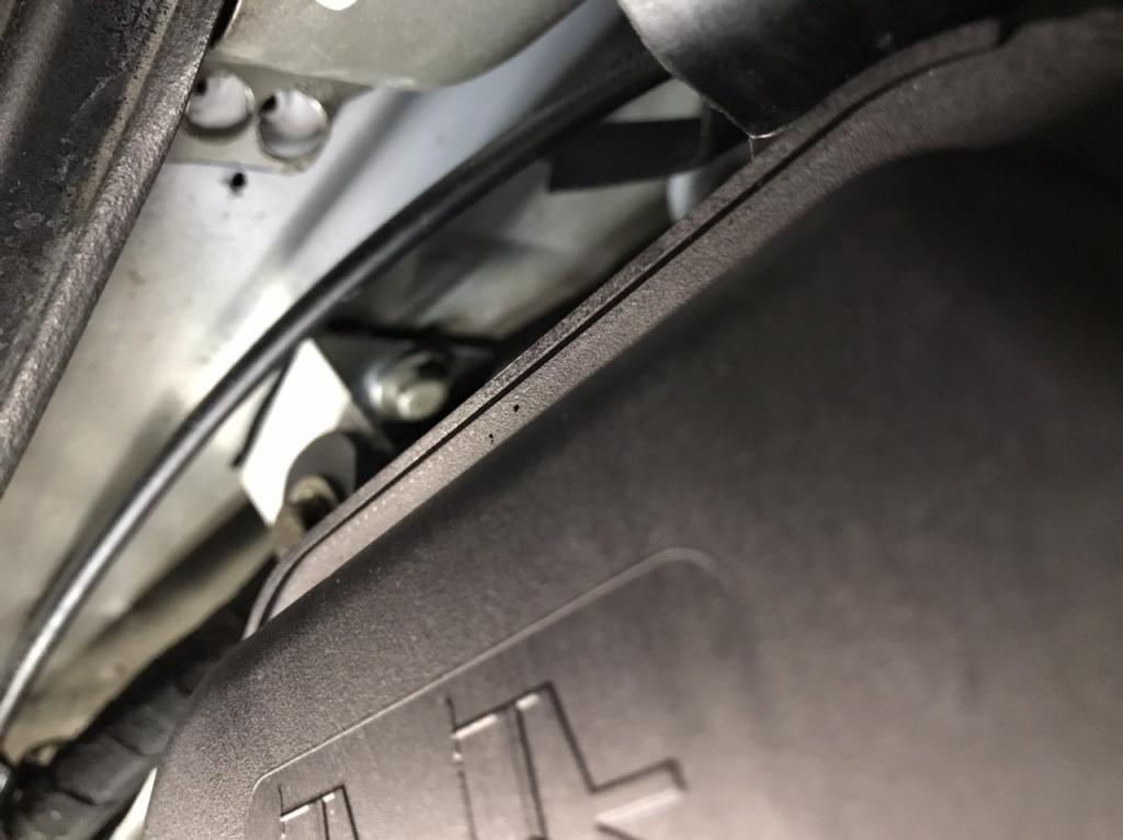

The hood should close with no issues according to my measurements but of course I won’t know for sure until it’s back on the car after I am done with this swap. I hope this helps others doing this swap if they wish to go this route.
