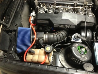

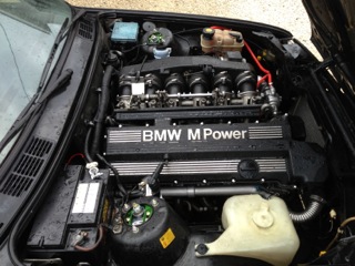

              Just some pictures of the completed engine bay!
                Well done !!
                Can you make the pics a little larger? S38 looks so at home in the E30 engine bay.

                  #38
                  Nice engine bay. Looks like your engine sits in position 1 with a custom radiator?

                      #40
                      Its in position 2 according to the DE mounts I have.
                      I used the same radiator as mentioned in this thread from Summit. Thanks for that tip btw!
